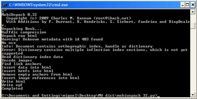

Hello adamselene,
I try to change the incorrectly set language code of a dictionary in order to make it work on the Paperwhite. I followed your script which runs - however, I get following "Error: Dictionary contains multiple inflection index sections, which is not yet supported".
I assume this breaks the process? Do you know of another possibility to change the in/out language of a .mobi file?
Thanks a lot!

Originally Posted by miquele View Post
Hello adamselene,
Thanks a lot!
Hmm... I don't know a lot about dictionaries, but I'd suspect that the language codes are in the header, and so could be changed without decompiling/recompiling. But I don't know of a tool to do that.
