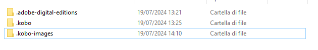

Adding ebooks from uSD
Ok guys I managed to fix my kobo glo.
I have another question, is it possible to insert an ebook file directly into the main SD card?
from file manager I see these 3 folder (in the attached photo)
do you think it's possible to do it? where should I put the files?

And content can go almost anywhere. Create your own folder called (for instance) books and copy content there
Sent from my Pixel 7a using Tapatalk

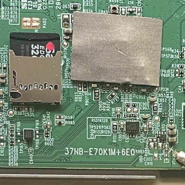

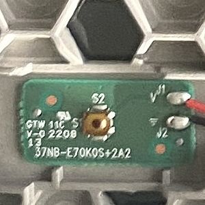

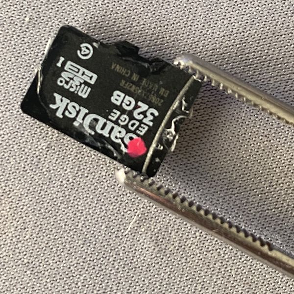

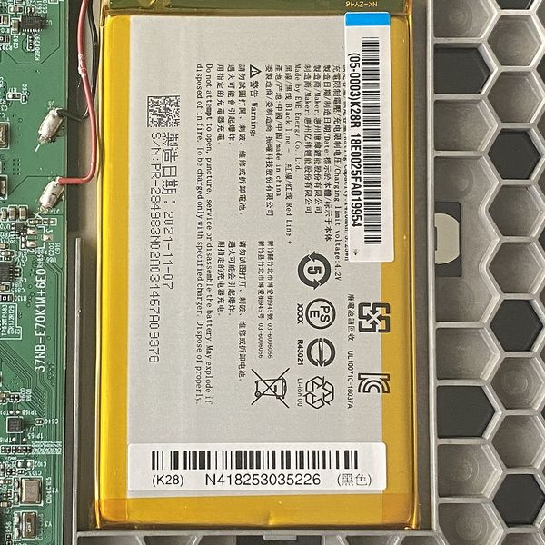

Thanks for the guide, it helped me unbrick my Kobo Libra 2 N418 I'll leave some notes here for future googlers.
- My original issue was that when I connected to a new wifi network, it seems to have tried to download a new update and then bricked itself (I had sideloaded NickelMenu a year or so ago and forgotten all about it). The white light at the front would flash/blink and I'd get a white screen. If I tried to reset the Libra 2, maybe it would go to a white screen with three dots, but it would always revert to the blinking light and white screen.
- Opening the case was easy with a very thin tool. I attach photos of the markings on the main PCB of my unit, the markings on the battery, and the markings on the little power button break-out board.
- My MicroSD card was glued in with a very thin (and very clear!) coating. I got it out by grabbing the sides of the chip with tweezers and wiggling it out (photo attached).
- The MicroSD card from my unit was completely corrupted, it refused to delete partitions and format no matter what software I used. A full replacement was needed. I prepared the new MicroSD card by deleting all partitions from it and adding a new lettered partition (with MiniTool Partition Wizard), and then formatting that new lettered partition with the SD Association's SD Card Formatter tool. I used Balena Etcher Portable to flash the image onto the card.
- I flashed the first revision image, but this didn't work. After the unit booted up and got to the language selection screen, it immediately turned off with a screen telling me that it needed to be charged. Since DNSB's message said that one of the changes between revisions was to the battery management chip, I reflashed with the Revision E image and that works fine.
- The unit's serial number no longer matches mine in the 'About' section. I don't know where to change this; I tried changing it in the .kobo/version file, but the change doesn't stick.
- The firmware wrongly announced that it was up-to-date. I updated it manually by extracting the latest firmware .zip to the .kobo folder and restarting the unit.
