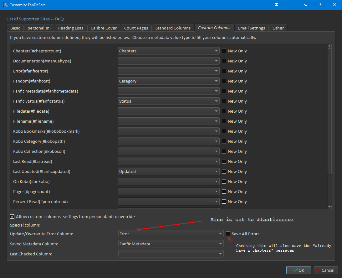

Here's a screenshot of the location.
Name:	2021-01-18 16_12_44-Customize FanFicFare.png
That's what I tried to use, but for some reason returned me a similarly random list of characters instead of error msg. Although I only tested it with one link, so I need to check it out further, to fully understand what I did wrong. What should the error output look like?
