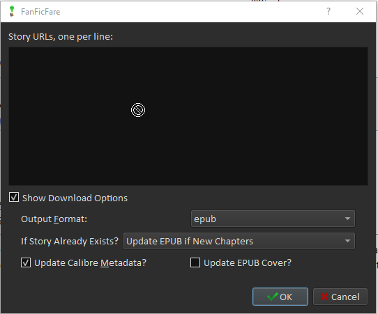

Can anyone else confirm that 2020-11-19 test version broke drag and dropping? Both Mozilla Thunderbird message list and browser fails.

Working fine for me.
Nothing has changed in FFF's code for drag and drop since the last release.

I just reverted to the stable version and it still doesn't work. I did do a Windows Update (kb4586781) a day or two ago. I wonder if that broke it.
Reboot?

It was a shell extension I use. Apparently the recent Windows Update caused it to break some instances of drag-and-drop between applications. I updated it and it's working again.
