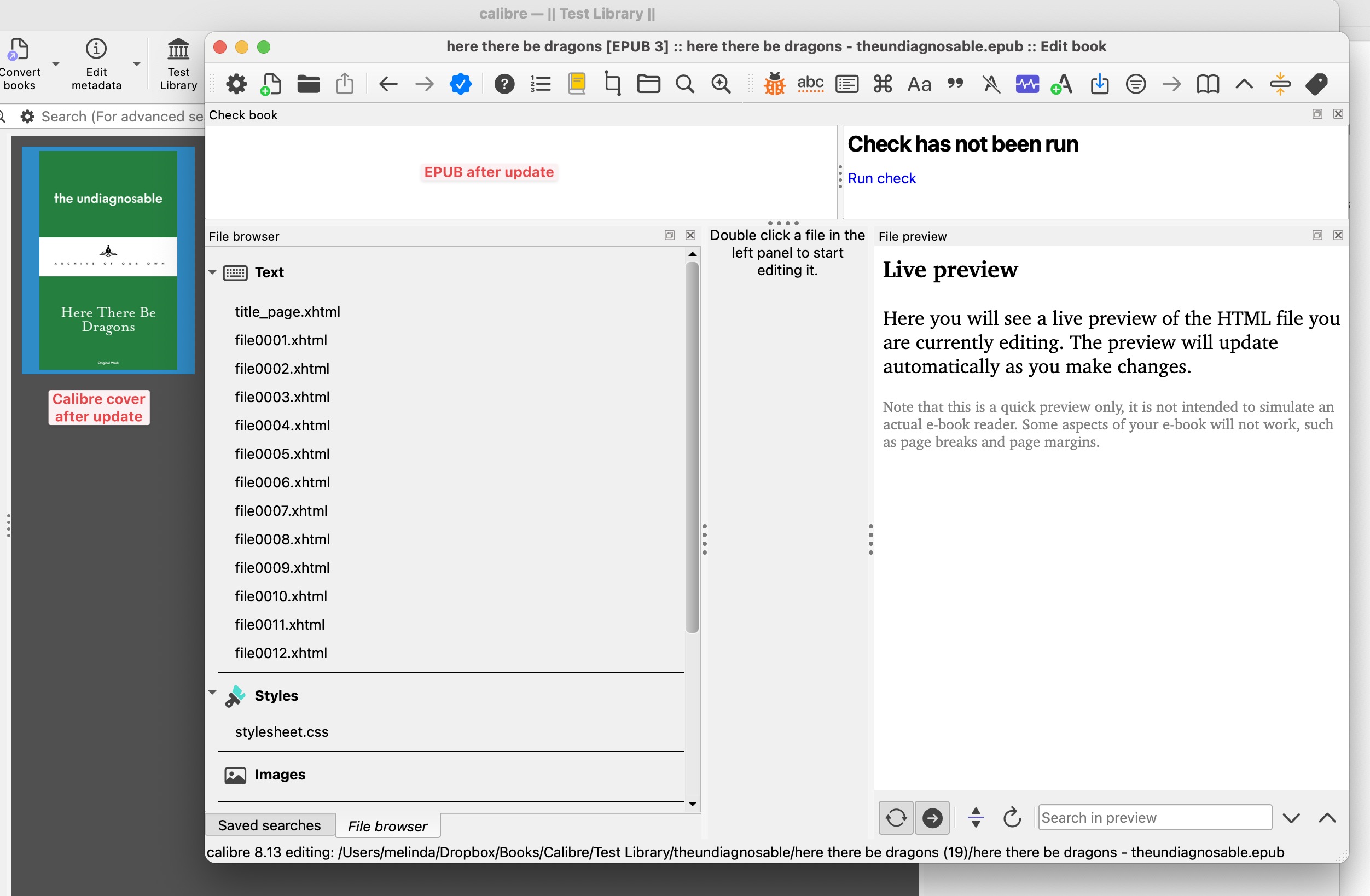

I must be missing something here or misunderstanding how this is supposed to work, because I already have use_old_cover:true in my defaults.
I've also tried adding it to the epub section since the default.ini talks about it there, but my injected cover pages & images are still getting deleted from inside the epub on update.
I’ve set up a new library to test, simplified the epub customizations in my personal.ini in the test library, and tried every plugin cover setting configuration I can think of, but I still can’t find a way to keep the existing covers within the epub itself.
To be clear, I'm having no problem keeping my Calibre covers, just the injected ones.

Here are some of the settings I’ve tried that retain the Calibre cover but delete the cover page file and image from within the epub:
1)
- Update Calibre Cover (from EPUB): Yes, if EPUB has a cover image
- Set Calibre Cover Only for New Books: On
- Generate Calibre Cover: No
2)
- Update Calibre Cover (from EPUB): No
3)
- Generate Calibre Cover: Yes, unless FanFicFare found a cover image
- Generate Covers Only for New Books: On
- Inject/update the generated cover inside EPUB: On
4)*
- Generate Covers Only for New Books: Off
5)*
*If "Update Calibre metadata" is checked during Update Always, settings 4 & 5 generate a new cover, update the Calibre cover, and inject the cover in the epub. Even if Update Calibre Cover is set to No. (see screenshots)
I feel like I must be missing something obvious here. Like I said before, I can always inject the Calibre covers into the epubs again, but I'd prefer to skip that step if it's possible, especially because of all the ORIGINAL_EPUB backups this creates.

FFF's cover system is an evolved, convoluted mess that I regret ever providing. Or at least, I should have said 'no' much more often when asked for additional options and features over the years.
In this particular case, however, the issue is less to do with covers per se, but using epub_version:3.0 and generated cover injection via Calibre Polish book and FFF epub update.
FFF, when it generates an epub3, puts both the epub2 and epub3 metadata files in for maximum back compatibility. Calibre's Polish Book, when updating an epub3, removes the epub2 standard <reference type="cover"> tag that FFF is looking for to find an existing cover image on update.
I will look more closely at what might be done to detect 'pure' epub3 covers this weekend. It looks straightforward, but I've thought that before.
FYI, Re: "Update Calibre Metadata" checkbox -- My first thought is that the "Update Calibre Metadata" checkbox shouldn't make any difference to the epub. That's literally one of the oldest settings in FFF.

Old 11-01-2025, 03:29 AM   #11424
slimcat
slimcat began at the beginning.
slimcat's Avatar
Posts: 16
Join Date: May 2025
Device: Kindle PW, iPad
I understand your regrets, but truly you are doing the Lord's work.
I added the <reference type="cover"> tag back in to a few books using the Set Semantics tool in Calibre’s ebook editor and did more testing. With that one change, I can update my epub 3 fics and keep the injected covers (Hooray!). Interestingly, that also fixes the weird “Update Calibre Metadata” behavior (it no longer appears to impact the epub).
If possible and straightforward (*knock repeatedly on wood*), that would be amazing. Right now, the issue with updating even after manually adding a cover entry to the OPF guide is that it deletes the cover-properties attribute from the manifest that's required for epub 3 (see screenshots).
Thanks again for the plugin and all your help. I sincerely hope I don't add to your regrets!
Name:	1 - Before udpate (after setting cover semantics).jpg
ID:	218982   Click image for larger version
Name:	2. plugin cover settings for update.jpg
ID:	218983   Click image for larger version
Name:	3. After update.jpg
slimcat is offline   Reply With Quote
Yes, it is more complicated.
  • Epub2 metadata marks a cover page--an (x)html file--that displays an image.
  • Epub3 metadata marks a cover image directly, with no special marking of the page that contains it.
  • To preserve presentation--because it does matter--FFF wants the cover page, not just the image.
  • Calibre marks the cover page <item ... properties="calibre:title-page svg">, both with Book polish inject and Edit book's Update Internals. But only on epub3. (No idea what the svg is about--it's a jpeg file.)
So now the "straightforward" solution appears to be to start looking for that "calibre:title-page" property in epub3 as well as adding it to FFF's epub3 output.
But I don't know if the svg is needed or is junk. Or why I've seen both "calibre:title-page svg" and "svg calibre:title-page".
FYI, the svg apparently refers to whether the cover page wraps the real cover image with a <svg> image to improve scaling. Apparently this workaround has been around for a long time. Link 1 Link 2
It looks like adding the <svg> wrapper to FFF via cover_content setting is trivial. (Does anyone already do that? Looks like this person does.)
Ideally, FFF should be looking for <svg> tags in all (x)html files and marking them with properties='svg' when writing epub3. Reference
Neither Calibre Edit book or Polish add that property when a <svg> is in a random file, but Covert does.

New Test Version Posted
2025-11-01
- adapter_storiesonlinenet.py - tolerate contest stories with "(Hidden)" author, #1272, thanks bpothier
- Find and use epub3 cover on update--relies on Calibre's calibre:title-page property.
- writer_epub: Also write the calibre:title-page property for epub3.
- writer_epub: Rearrange to detect and flag files containing svg tags for epub3.
This should address slimcat's cover issues.
In theory, rearranging the order writer_epub writes files shouldn't matter. (Yes, I have still kept the 'mimetype' file first and uncompressed as required.)
In practice, it would not hugely surprise me if some readers care.

Your update did the trick. Thank you so much!!!
FYI: You can opt out of SVG covers in Calibre's Output settings (which I did, since it's my understanding that using svg wrappers is more of a legacy technique), and if you do you don't get the svg tag in epub3, just "calibre:title-page."
Name:	svg output settings.png
