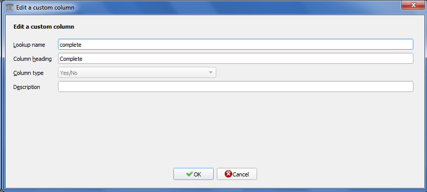

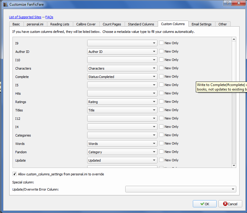

I've come across a very odd problem. This search term no longer works for me:
#complete:"False"
As far as I can see I haven't done anything wrong, I've attached screenshots of my custom column and how it's configured in FFF.

Name:	Skærmbillede 2015-04-30 10.43.45.png
ID:	137747   Click image for larger version
Name:	Skærmbillede 2015-04-30 10.44.05.png

It correctly comes up as In-Progress for me, on the title page inside, in tags and in a y/n custom column. Does it show status correctly on the title page inside the ebook? That will tell if it's something in replace_metadata or after that.
