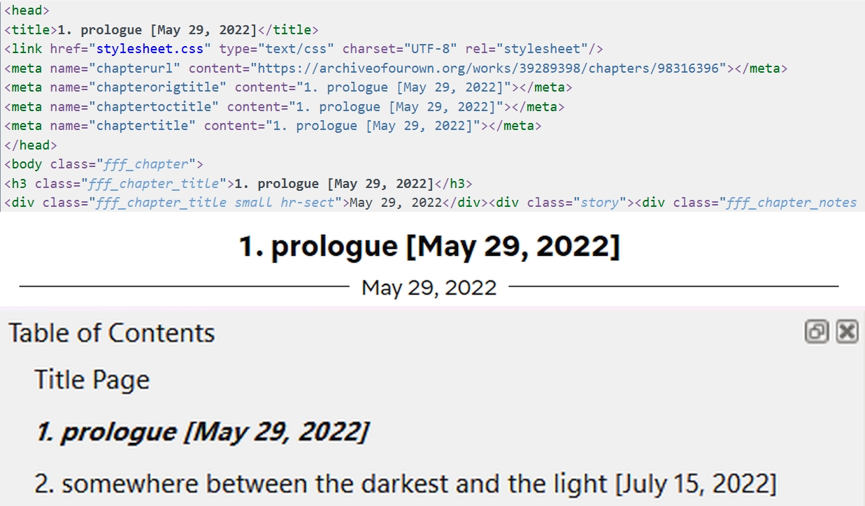

I mean I wanted to set a chapter title pattern for the embedded TOC and a different one for the chapter HTML. I've tried ${origchapter}/${tocchapter}/${title} in chapter_start and the output was the same as ${chapter} since the pattern was being overwritten by chapter_title_x_pattern.
[archiveofourown.org]
## The basic pattern used when not using add_chapter_numbers or
## mark_new_chapters
chapter_title_def_pattern:${title} [${date}]
## Pattern used with add_chapter_numbers, but not mark_new_chapters
chapter_title_add_pattern:${number}. ${title} [${date}]
## Pattern used with mark_new_chapters, but not add_chapter_numbers
## (new) is just text and can be changed.
chapter_title_new_pattern:${title} [${date}] | (NEW)
## Pattern used with add_chapter_numbers and mark_new_chapters
chapter_title_addnew_pattern:${number}. ${title} [${date}] | (NEW)
chapter_start:<?xml version="1.0" encoding="UTF-8"?>
 <!DOCTYPE html PUBLIC "-//W3C//DTD XHTML 1.1//EN" "http://www.w3.org/TR/xhtml11/DTD/xhtml11.dtd">
 <html xmlns="http://www.w3.org/1999/xhtml">
 <head>
 <title>${chapter}</title>
 <link href="stylesheet.css" type="text/css" charset="UTF-8" rel="stylesheet"/>
 <meta name="chapterurl" content="${url}"></meta>
 <meta name="chapterorigtitle" content="${origchapter}"></meta>
 <meta name="chaptertoctitle" content="${tocchapter}"></meta>
 <meta name="chaptertitle" content="${chapter}"></meta>
 </head>
 <body class="fff_chapter">
 <h3 class="fff_chapter_title">${chapter}</h3>
 <div class="fff_chapter_title small hr-sect">${date}</div>
[overrides]
strip_chapter_numbers:true
add_chapter_numbers:true
mark_new_chapters:latestonly
(Attached is result)
But what I want is ${number}. ${title} [${date}] on embedded TOC, but only ${number}. ${title} on the EPUB output.
culytera is offline   Reply With Quote
Yeah, can't do that right now.
I might be able to leverage something in, but there's already several different chapter title patterns running around. May look at it next week if I remember.
