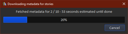

Additionally: Is it unavoidable (or very difficult to fix) for the 'cancel' button here to become unresponsive? I accidentally forgot to delete the URL for a some fics I didn't want and had to wait and then reject them.
Dunno. I thought it did. There's some code in there that suggests it may be different on mac. I know that I added code to disable the progbar dialog Cancel button (same dialog) on calibre data update because I clicked it by accident one too many times.
