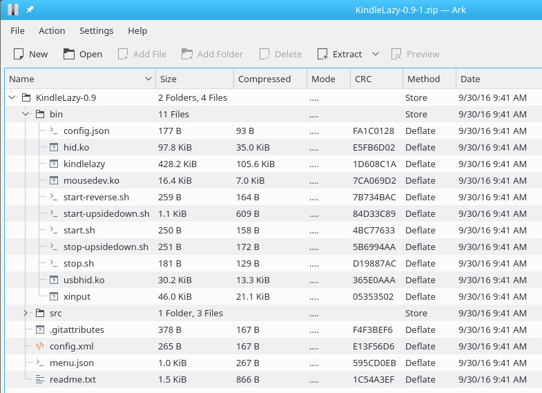

IIRC, the Amazon kernel build did not (at the time of this project start) ship a complete set of USB serial modules (dynamically loaded drivers, loaded by the kernel).
See first post, where this work is based on the adding of mouse support (which also requires USB serial modules).
Start at post #1 here (or better yet, at the mouse support thread, which this extends).
Look for a mention of the kernel build information, it MUST match what you just listed or the modules have to be rebuilt.
(The kernel will not load modules not built specifically for it.)
OR
do a modinfo command on the modules that this (or the mouse support thread, if KL is using those modules) - they must match:
3.0.35-lab126 #2 PREEMPT Tue Dec 4 17:14:27 PST 2018 armv7l GNU/Linux
This thread was started Sept. 2016, so the modules could not have been built to match a Dec. 2018 kernel.
As I originally posted, build the required modules to match your kernel build or get someone to do it for this project thread.

Originally Posted by mrpops View Post
okay thank you, i'll put in another 5 or 6 hours tomorrow and use some of those words you mentioned to progress further.
thank you for confirming it seems possible, that really helps motivation.
Are you picture oriented?
Pull up the attached picture.
See the files in the path: KindleLazy-0.9/bin/<name>.ko (ko == kernel object)
Amazon posts the sources of the open source things they used, and if your lucky, the compiler they used.
/proc/config.gz on your Kindle should have the configuration file Lab126 used to build the kernel that is running at that moment.
Use that config file + build as modules the ones listed above, follow the kernel build system instructions.
People have been posting on 'net since 1991 on how to build the kernel and its modules - there is no shortage of pre-written directions.
Or hope someone here offers to do the job for you.
And say something nice about my new dog.

Old 02-10-2019, 05:17 PM   #239
mrpops
mrpops began at the beginning.
Posts: 21
Join Date: Feb 2019
lhasa apso? very cute
discovered this, maybe it will help me tomorrow
Prerequisites
On Ubuntu 12.04, you will need the following packages installed:
  gawk
  wget
  git
  diffstat
  unzip
  texinfo
  build-essential
  chrpath
  socat
  libsdl1.2-dev
  xterm
  libssl-dev
Building the Toolchain
To build the toolchain, You need to setup a poky 1.8.1 environment
To setup environment:
Clone Poky 1.8.1 by following the instruction from https://www.yoctoproject.org/downloads/core/fido181
Execute the folling command to setup a environment
  $ source poky/oe-init-build-env build
  $ cd build
To build toolchain,execute the follwing command after setting up an environment
  $ bitbake gcc-cross
or this
In order to compile the kernel, use the following configs:
	Kindle Oasis:  imx60_duet_defconfig
	Kindle Paperwhite (6th & 7th generation), Kindle Voyage (7th generation), Kindle (7th generation):  imx60_wario_defconfig
Use the following command to run the configs:
    make ARCH=arm CROSS_COMPILE=<path to gcc linaro>/bin/arm-linux-gnueabi- <configure>
Use the following command to compile:
Prerequisites
  gawk
  wget
  git
  diffstat
  unzip
  texinfo
  build-essential
  chrpath
  socat
  libsdl1.2-dev
  xterm
  libssl-dev
  $ cd build
  $ bitbake gcc-cross
Check the contents of the Amazon source code package for your device/firmware combination.
https://www.amazon.com/gp/help/custo...deId=200203720 (page down, way down)
It may already have the toolchain built.
If not, you can probably use the one NiLuJe has posted in his snapshots thread.
Close, same family of breeds.
