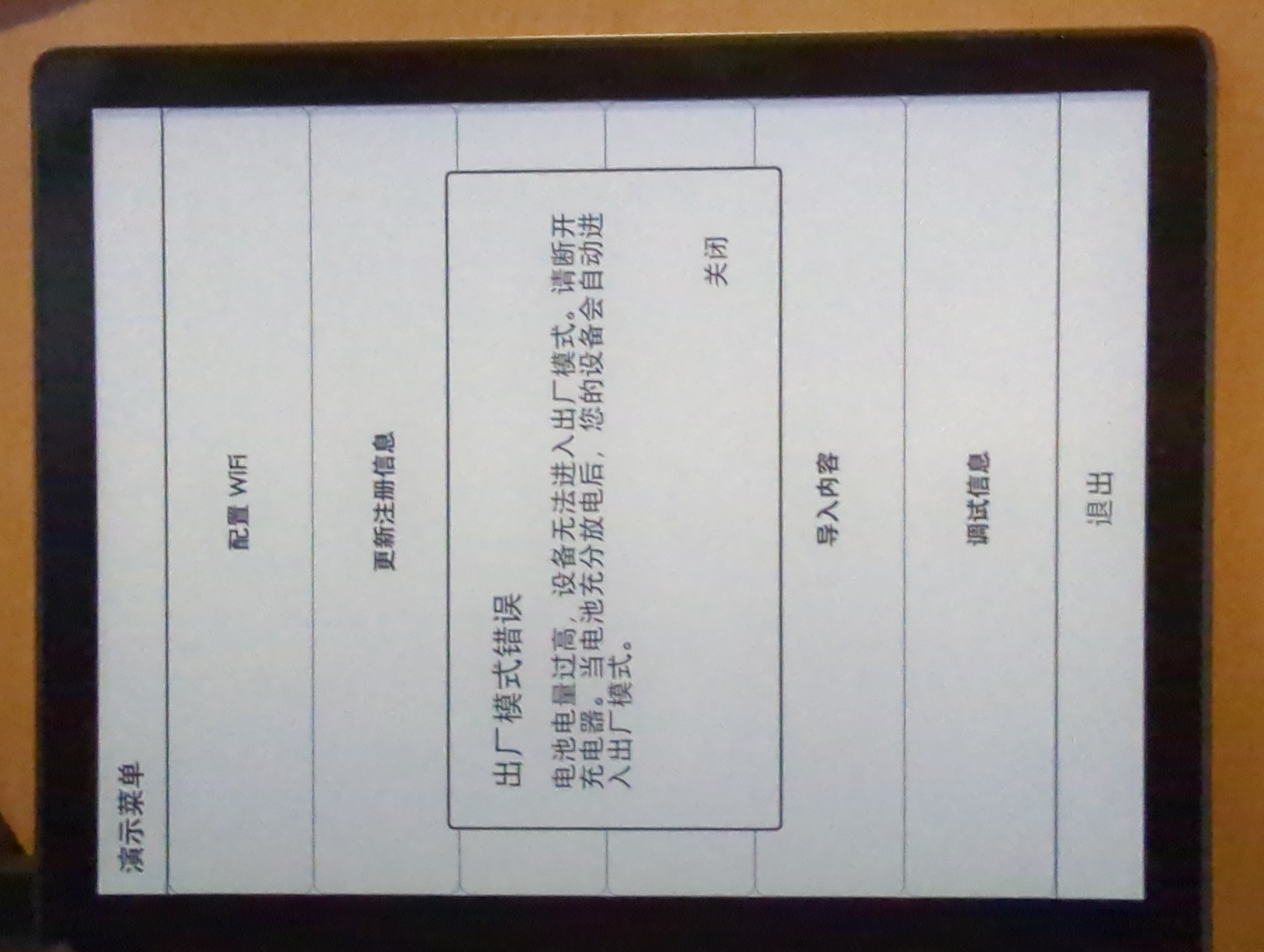

TI have an Oasis 3 version 10
I'm stuck in Chinese...I have no clue how to get out of there.
I used google translate and the error message is something about to much battery power an not be able to reboot

Marek replied to another user that this is because the files were not copied correctly.

Thanks, it seems that it worked now

I have a paperwhite 3, and I had a very similar experience. MANY attempts, but I finally got pretty far last night before hitting a new frustrating problem (More on that below)
I think things went sideways (guessing) either because I didnt have airplane mode on when starting, and/or when, after selecting reselling device to not copy over the files and eject safely, or after the KPP crash I would force a reboot.
Eventually last night I was able to pull it off. So hang in there, keep trying.
I thought I would never get the weird Psuedot button even when I thought it was working, but eventually I did.
I got everything dialed in and installed it was great. But I couldn't get it out of managed mode. When i ;demo to get out of manage mode it wipes all the of CFW/JB/KUAL everything.
so close, yet so far away.
Anyone know how I can NOT lose everything and still somehow get out of the managed mode.
Thanks in advance
moshin is offline   Reply With Quote
Old 01-24-2024, 01:42 PM   #734
Marek
Marek ought to be getting tired of karma fortunes by now.Marek ought to be getting tired of karma fortunes by now.Marek ought to be getting tired of karma fortunes by now.Marek ought to be getting tired of karma fortunes by now.Marek ought to be getting tired of karma fortunes by now.Marek ought to be getting tired of karma fortunes by now.Marek ought to be getting tired of karma fortunes by now.Marek ought to be getting tired of karma fortunes by now.Marek ought to be getting tired of karma fortunes by now.Marek ought to be getting tired of karma fortunes by now.Marek ought to be getting tired of karma fortunes by now.
Marek's Avatar
Posts: 196
Karma: 1512344
Join Date: Jul 2023
Device: PW3, PW4 :(, KT5, PW5, KLC
Thanks in advance
You WILL lose everything you aren't supposed to install kual until you have finished the jailbreak (exiting managed mode is part of the process) so just exit managed mode and start over (starting with reinstalling the hotfix)
