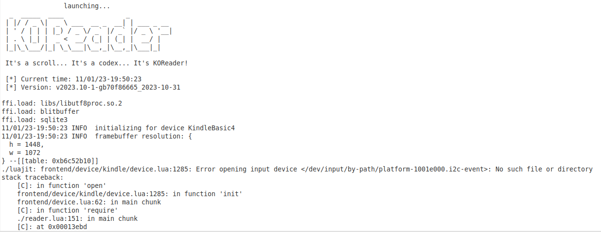

KO Crash Log
Originally Posted by mergen3107 View Post
Most importantly, please go to koreader folder on Kindle via PC, then bring here the crash.log file, it has details of why it didn’t like something.
If it says “cannot refer framebuffer” or something like this, then your JB wasn’t complete. Try multiple restarts and reinstall hotxies and do restarts again.
I've attached a picture of the crash log

Thanks!
I assume @NiLuJe can fix this soon?
mergen3107 is offline   Reply With Quote
Old 11-01-2023, 10:09 PM   #233
NiLuJe
BLAM!
NiLuJe's Avatar
Posts: 13,506
Karma: 26047202
Location: Paris, France
https://github.com/koreader/koreader/pull/11064

Spoiler alert: you do not, in fact, possess a PW4 as your info box suggests . That was a KT5.

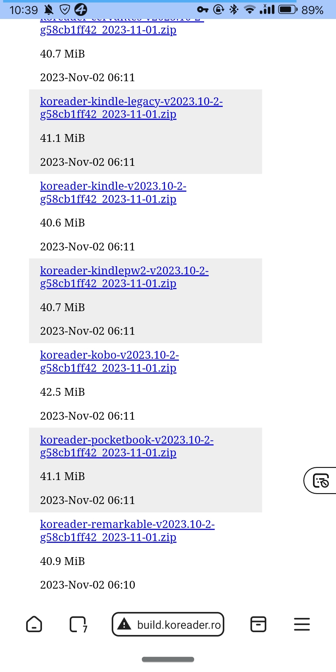

Is this the nightly we're waiting for?
@QBit99
Thanks for your help and patience. The fix is in, will be merged soon and appear in the nightlies.
It's been added recently

No, not yet. The linked PR that NiLuJe gave you hasn’t been merged yet (it’s color on GitHub will turn purple). And only then we need to wait more until new nightly is rolled out.
Nightly will have at least 10-3 in the name.
