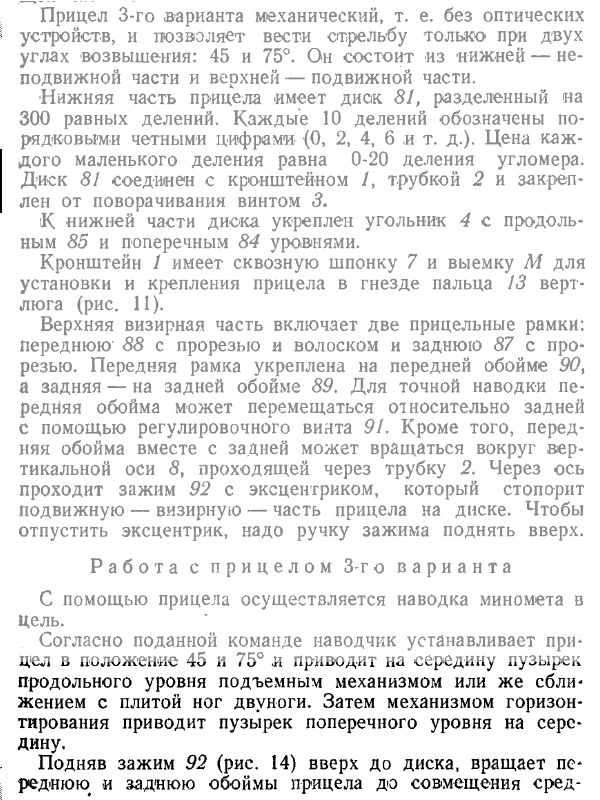

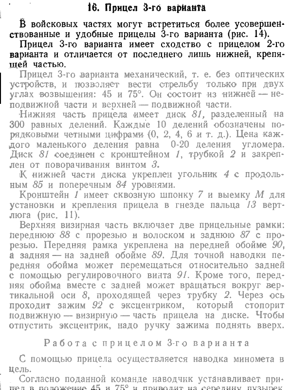

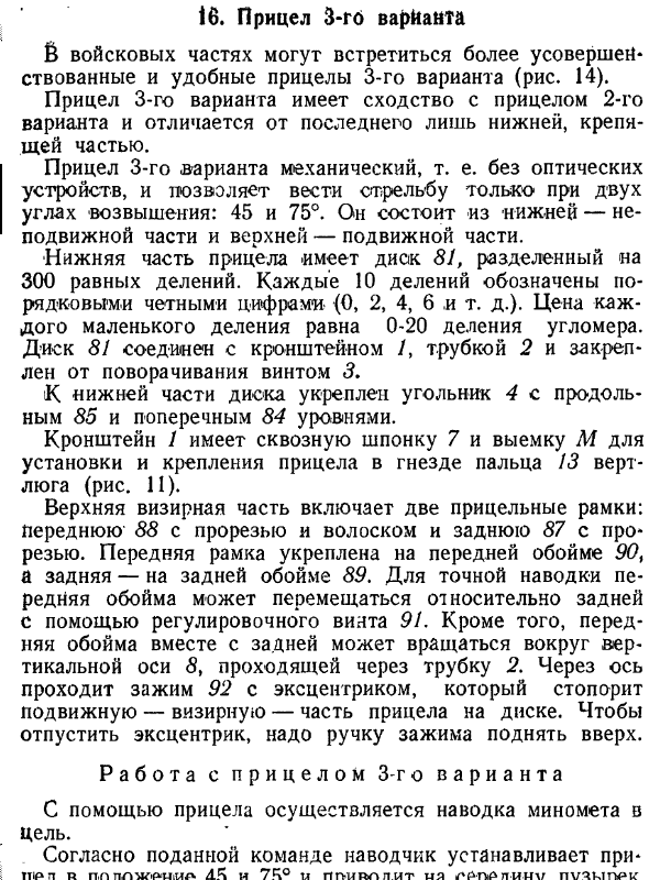

Old 04-18-2013, 01:05 PM   #174
dimasic
dimasic knows the difference between 'who' and 'whom'dimasic knows the difference between 'who' and 'whom'dimasic knows the difference between 'who' and 'whom'dimasic knows the difference between 'who' and 'whom'dimasic knows the difference between 'who' and 'whom'dimasic knows the difference between 'who' and 'whom'dimasic knows the difference between 'who' and 'whom'dimasic knows the difference between 'who' and 'whom'dimasic knows the difference between 'who' and 'whom'dimasic knows the difference between 'who' and 'whom'dimasic knows the difference between 'who' and 'whom'
Posts: 43
Karma: 10000
Join Date: Apr 2013
Device: Kindle 4NT
Here you are!
Settings: "Fit to content width", "Overlap shading on", "Comics mode on" (as in "CM off" mode "OS on" does almost nothing, except of greying out up to couple of text strings). The pages are tall and don't fit to the screen. The text is black (screen1.png), we press the "next page" to move to the rest of the page. This rest of the page (the text) is black and the part we have read is grey (screen2.png). It's all OK. But if we move backward, to the beginning of the page, we get the picture, in which only small upper part of the text is black, but the bigger part of it is grey (screen3.png). All the page should be black because of a human reads from up to down and because of just one page turn before we saw the text in black and because of the grey page looks very uncomfortable.
The reading of miscellaneous handbooks means seeking forward and backward through the book, and such behavior of overlap shading bothers very much and makes overlap shading almost useless.
And it would be nice to turn on "Comics mode" automatically when the "Overlap shading" is on and to return to previous state of "CM", when overlapping is off. And probably to turn off overlapping shadow when we turn off CM. Some kind of AI.
ID:	104561   Click image for larger version
ID:	104562   Click image for larger version

@dimasic
The behaviour you described is not a bug at all. It behaves as it should. Part of the page that was shown on the previous screen is shown as grayed out. It doesn't matter if it was shown as black or grayed out - if it was shown on previous screen, it will be grayed out on the current one. That's how it was intended to work. Pictures show that that's exactly the case. If you don't want to see gray text when going backwards, just turn overlap shading off before it, and turn it back on before you go forward again. Or, press backward once more, and then forward once. It might be a bit difficult to switch overlap on and off on K4NT, but it's only 1 key on K3, and quite easily usable.
Overlap shading is not useless if the comics mode is off, because Librerator overlaps 30 pixels by default. Meaning, 30 pixels from the bottom of the previous view will be on top of the next view. (Remember, Overlap shading grays out what was shown on previous screen). Depending on the font, sometimes it will be 1 line, sometimes 3, sometimes 1 and a half - so overlap shading helps find where to continue reading to the people that want it.
As I already explained, both Comics mode and Overlap shading have independent uses, and having one automatically turn on or off the other is not a good idea. You shouldn't assume that what works for you would work for everyone else.
I, for example, don't use Overlap shading, and always use Comics mode. I pan down early, on paragraph break. Depending on the text, this is not always possible. So sometimes, very rarely, I turn Overlap shading on for just a second, to see where I was, then turn it immediately off. It's quite easy to do this on K3.
Other people, for example, don't like comics mode. Especially if they mostly read novels. Some of them might still prefer overlap shading.
To each his own.
Regards,
Kai

Old 04-18-2013, 04:00 PM   #176
dimasic
Posts: 43
Karma: 10000
Join Date: Apr 2013
Device: Kindle 4NT
So do you think that when we turn the page forward by one step and backward (by one step too), it should become almost all greyed out? I don't understand why and what for. When we read the remain of the page at the bottom (it's black and the upper part is grey) and then return to the upper part of the page, we don't see the bottom, but do see only the main part. So why it's grey? Maybe to damage my eyes? Okay, I won't use this mode at all. If this is not a bug, but feature, this feature is not looks reasonable. To make the text black as it was, I should press two more buttons - backward and forward? So for simple returning to the previous page which was black I should press THREE buttons (back-back-fwd), not one. Oh, no. No, thank you.
dimasic is offline   Reply With Quote
Old 04-19-2013, 01:58 AM   #177
Kai771
Just a Noob
Kai771 can program the VCR without an owner's manual.Kai771 can program the VCR without an owner's manual.Kai771 can program the VCR without an owner's manual.Kai771 can program the VCR without an owner's manual.Kai771 can program the VCR without an owner's manual.Kai771 can program the VCR without an owner's manual.Kai771 can program the VCR without an owner's manual.Kai771 can program the VCR without an owner's manual.Kai771 can program the VCR without an owner's manual.Kai771 can program the VCR without an owner's manual.Kai771 can program the VCR without an owner's manual.
Kai771's Avatar
Posts: 145
Karma: 162610
Join Date: Aug 2011
Device: Kindle 3
What will become gray depends on what was shown on the previous screen. You're only having in mind your case, where you only have a few lines on the second screen. There are situations where both screens are roughly the same size. Going back doesn't always mean that you'd want to read the whole page. What if you wanted to read only the top paragraph, that wasn't shown completely on the 2nd screen?
The function is called overlap shading. Whatever is "overlap" (content shown on previous screen) is shaded. Perfectly logical if you ask me. There is no such thing as "main part" - if it was shown on the previuos screen - it's overlap. It is gray to indicate that it was shown on previous screen. What you actually want is overlap shading working just in forward direction. It might suit you, but would probably not suit someone else.
