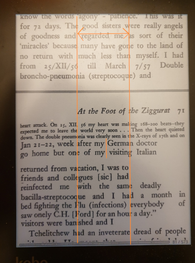

another pdf problem not encountered before: I OCR'd the pdf myself with Adobe Acrobat DC2019 (60 MB, with pictures). The pages are too wide to read them even in landscape, so I switched to text reflow. Every 20 page or so a paragraph's font turns minuscule, and sometimes even lines are mixed up. Could this be due to low RAM or processor of my Kobo? I'm on KoReader 2019.12 - screenshots

That's definitely a curious effect, but the cause seems fairly straightforward. Due to the way the text lines up perfectly the algorithm seems to have misinterpreted it as two columns. By default it scans the middle third of the page for column gaps, and within that zone it seems to have found some.
If you're already using tools on your computer it's more expedient to just throw https://www.willus.com/k2pdfopt/help/overview.shtml into the mix. The same program provides functionality for KOReader, but by using the GUI or the command line you can tailor it in much more detail and much faster. (Use max columns: 1.)

edit: the column is gone, but the minuscule text remains
after running my entire 573 pp. pdf through it, the processed output pdf is now 169 MB, 1460 pp. This is not what I want for my book archive. Rather a perfectly OCR'd pdf, book layout, 1 column, correct font sizes, that is faithfully transmitted in KOReader reflow. K2pdfopt is good if you want to quickly read a text on your reader and then delete it. But thanks for the tip

If you select native PDF output it might be smaller, which may also load faster on a device.
I'm not really sure what the deal might be with the small text. Maybe @NiLuJe knows?

I ran the two pages through AbbyFineReader12 and now it's ok in K2pdfopt.
my only problem is, AbbyFinereader compresses the pdf too much (I think it's MRC compression) and then my Kobo has trouble opening the file, I've posted something about it earlier.
edit: I've been experimenting a bit more with the OCR functions of Abby and K2pdfopt, but I couldn't manage to get a proper reflow text of the book on my Kobo

I suspect the small text might indicate that k2pdfopt interprets that block as an image. But I don't see an obvious reason for it like with the columns. A lot of noise/speckling might cause that, for example, but there is none. There's some minor warping but nothing that seems like it should be problematic. Nevertheless it might be worthwhile to quickly try the autostraighten option in k2pdfopt.

auto-straighten didn't help either, unfortunately
