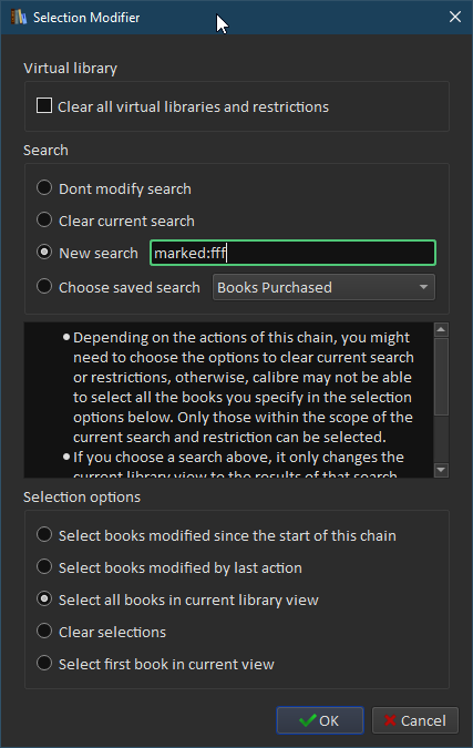

ownedbycats
Custom User Title
ownedbycats's Avatar
Posts: 11,389
Karma: 79699999
Join Date: Oct 2018
The FFF plugin has a signal it will emit after the "proceed with updating your library" dialog.
The code for the Action Chains Module I tested with is:
from calibre_plugins.action_chains.events import ChainEvent
class SearchChanged(ChainEvent):
    # replace with the name of your event
    name = 'FFF done'
    def get_event_signal(self):
        return self.gui.iactions['FanFicFare'].download_finished_signal
All I've done with it is call a chain that printed 'HERE!'.
If 'mark added/updated books when finished' is enabled, these selection modifier settings will select all updated books.
Name:	2024-05-29 20_30_43-Selection Modifier.png
I created a chain with this selection modifier and then a chain caller to my fanfic cleanup chain. Seems to work as intended.
Old 05-29-2024, 09:03 PM   #9641
JimmXinu
Plugin Developer
JimmXinu's Avatar
Posts: 7,166
Karma: 5006097
Location: Midwest USA
That reminds me about something that could be helpful.
FFF actually uses different marks for successful, failed and chapter error, as well as for an updated/created anthology:
  • fff_success
  • fff_failed
  • fff_chapter_error
  • fff_anthology
Technically, each book is marked with a sequence number like, "fff_success_0001" so that order is also preserved.
