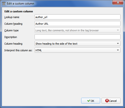

I have URL columns for Author and Story (not the same column), it's comments-columns.
Is it possible to make the URL's clickable instead of just plain-text?
Thanks
