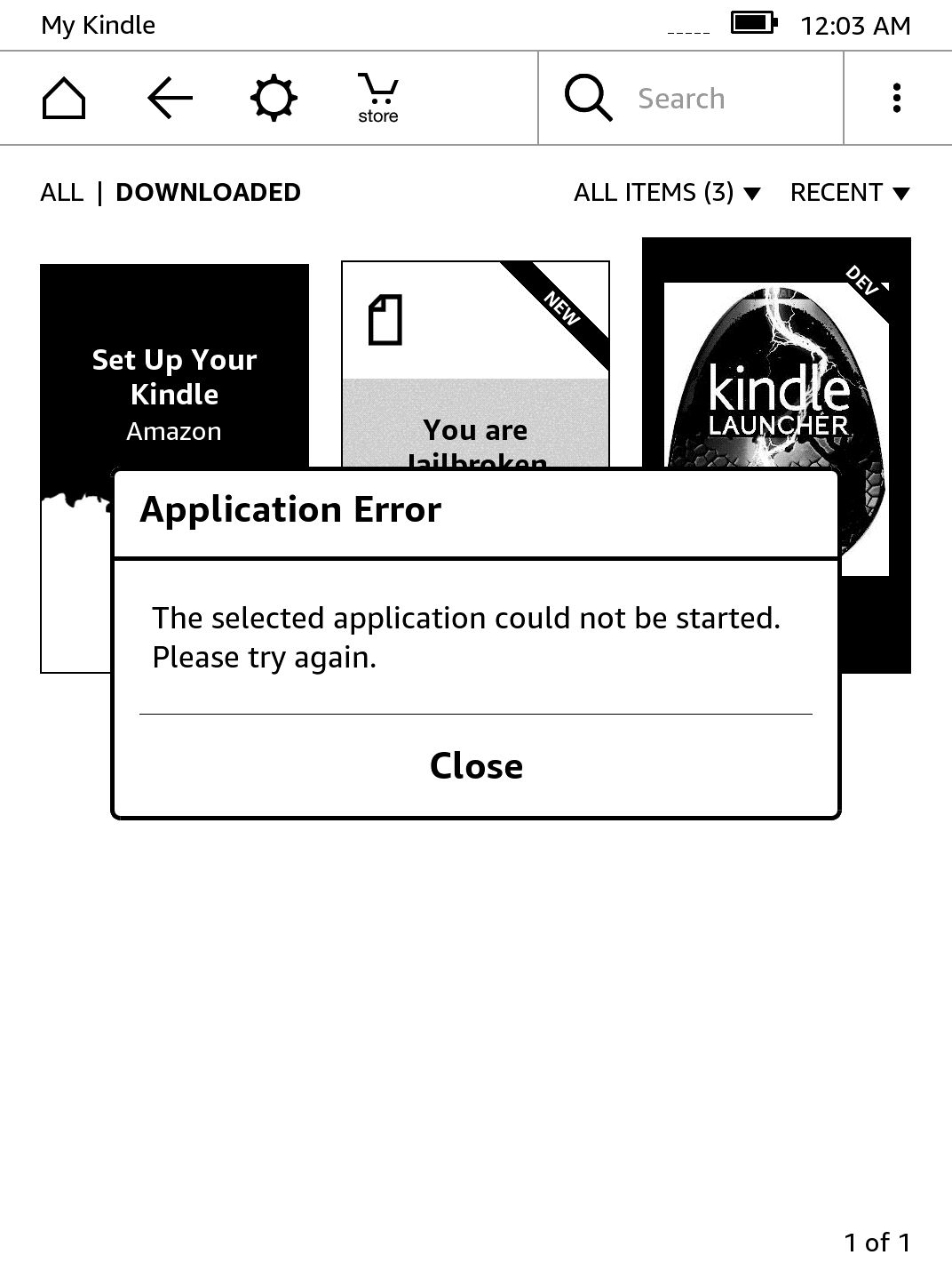

I did test this Morning by using the "Update_jailbreak_hotfix_1.14.PKOA_GR_install. bin" renamed to "Update_jailbreak_hotfix_1.14.N_install.bin" (According to knc1 information). From the Software Update screen, it show "Update Successful, Your Kindle is Restarting.....".
After that, I placed “KUAL-KDK-2.0.azw2” to documents folder & placed “Update_KUALBooklet_v2.6.40_install.bin” to mrpackages folder. During run Kindle Launcher, it shows Error again. (See attached pic).
This is the situation now
I do wish you would update your device listing in your info box or at least mention what model you are talking about in each post.
It would save us both a lot of time.
I went back to:
https://www.mobileread.com/forums/sh...postcount=2246
64 posts and several pages back - -
To discover you are working with a KOA not a PW3.
So to correct my last post:
See where you:
Well, delete it, it will not work on a KOA.
It is not suppose to work on either 8th. generation device, Amazon dropped support for 'active documents'.
You MUST use the booklet form of KUAL.
You MUST use MrPI to install the booklet form of KUAL.
You MUST use the search bar command:
;log mrpi
The semi-colon is part of the command to run MrPI.
The only reason for the error you are seeing now is because you are trying to use the build of KUAL which is not suppose to work on a KOA.
The only thing it will do on either a KT3 or a KOA is produce the error message you posted.
What you are seeing and reporting is the reason we made a booklet form of KUAL.
