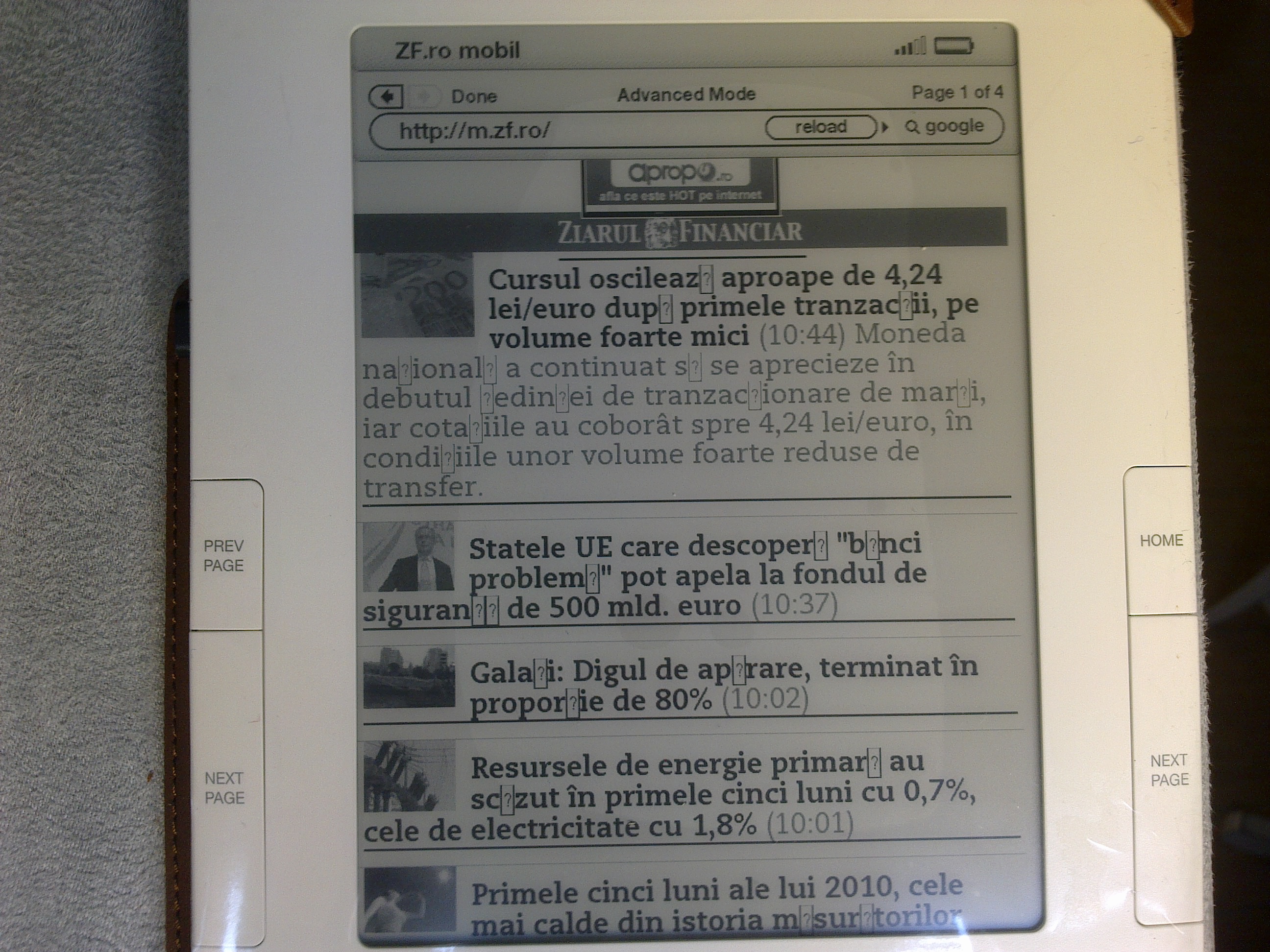

Here is my case:
I got a Kindle2 international version. software is the current one 2.5.3.
As I am from Romania I tried to use Calibre and mobipocket creator to convert some romanian books...
In romanian language there are some special diacritics and those fail to display corectly, except for the books in epub format, wich was converted OK. (is it possible that Kindle have romanian diacritics but i did the conversion wrong?)
Another issue is that also romanian webpages also are displayed with lot of ugly squares...and makes the browsing experience very bad.
I am ready to proceed to jailbreak and font hack, but I am not sure where can I find romanian fonts and which type should i look . Any ttf with romanian diacritics will work?
All I have to do is font hack, and after that rename my fonts and overwrite them in /linkfonts folder?
Thank you for your answer,
Alex
Alex73 is offline   Reply With Quote

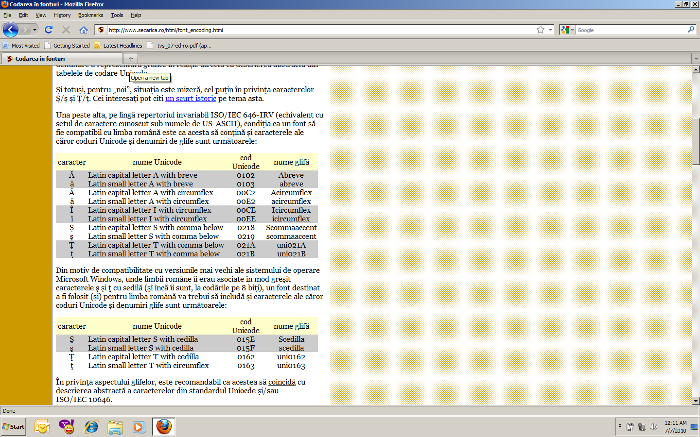

Thank you for your fast answer.
I attached a photo and a print screen with some info about romanian special caracters that i found on this site:
http://www.secarica.ro/html/font_encoding.html
There are some info there but the site is in romanian ...
Thank you very much for your time. It will be a major improvment for romanian users, to be able to see our language displayed corectly..
Alex

The default font should at least support part of the Romanian diatrics, but I'm not entierly sure about that... Because there's two way to display those diatrics, and it depends on the fonts (either you got a glyph for the basic latin letter, and a glyph for the diatric, and the software combines the two, or, and it's the more widespread method, because of compatiblity issues, you got a single glyph for each letter+diatric combinations).
Bottom line: I'd have to check to be sure.
Here is a possible clue to that issue:
Romanian language using the Latin alphabet, which in terms of characters and their graphic representation is simple and direct: each character is matched - or should I match - a single gluph with a graphical representation of the graphical representation and name directly related to abstract descriptions of the tables in Unicode encoding.
Altogether, besides invariably repertoire of ISO / IEC 646-Irv (equivalent character set known as the US-ASCII), provided that a font is compatible with the Romanian language is that it contain Unicode characters whose code glife and names are as follows:
caracter
nume Unicode
cod Unicode
nume glifă
Ă
Latin capital letter A with breve
0102
Abreve
ă
Latin small letter A with breve
0103
abreve
Â
Latin capital letter A with circumflex
00C2
Acircumflex
â
Latin small letter A with circumflex
00E2
acircumflex
Î
Latin capital letter I with circumflex
00CE
Icircumflex
î
Latin small letter I with circumflex
00EE
icircumflex
Ș
Latin capital letter S with comma below
0218
Scommaaccent
ș
Latin small letter S with comma below
0219
scommaaccent
Ț
Latin capital letter T with comma below
021A
uni021A
ț
Latin small letter T with comma below
021B
uni021B
Sorry for the last part, dunno how to format it like a table.
Hope this helps
TY
Alex

Yep, Caecilia (the Kindle's default Serif font (used in the books, and it's also the default font in the browser)) is indeed missing some combined diatrics. (It does support some diatrics though, ie. the few ones used in french ^^).
Good news is, both Droid & DejaVu have them all (AFAICT).
So, with this font hack, and some particular sets, for example, Museo or DejaVu (And possibly other fonts, I didn't check more than that, if you want me to check a particular font before trying it out, don't hesitate to ask ), you should have a font supporting most (if not all) of the diatrics needed for romanian script.
EDIT: Scratch that, Droid Serif is missing the two 'T comma below' glyphs.
EDIT²: But DejaVu does. I'll attach a DejaVu set to this post .
If you prefer the 'Serif Slab' look of the default font to a classic Serif, the Museo Slab set in my third post should support the needed combined diatrics.
