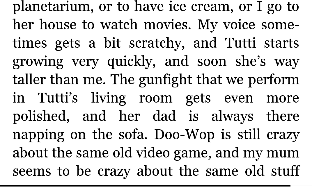

Progress bar Black to Grey.
Hi, I would like to ask if is there a patch to change the color of the progress bar from black to grey/dark grey. thank you
There are various progress bars in the GUI. Which specific one are you asking about?

The progress bar at the bottom of the page in reading mode.

I had a look around in the nickel CSS files for progress bar stuff. I did find one instance which looked hopeful but unfortunately, when I beta-tested a different bar colour, it only affected the progress bars on the book reading stats page (More > Activity) not the one at the bottom of the reading page - as in your screenshot.
Sorry I can't be of more help.

It is ok, Thank you
