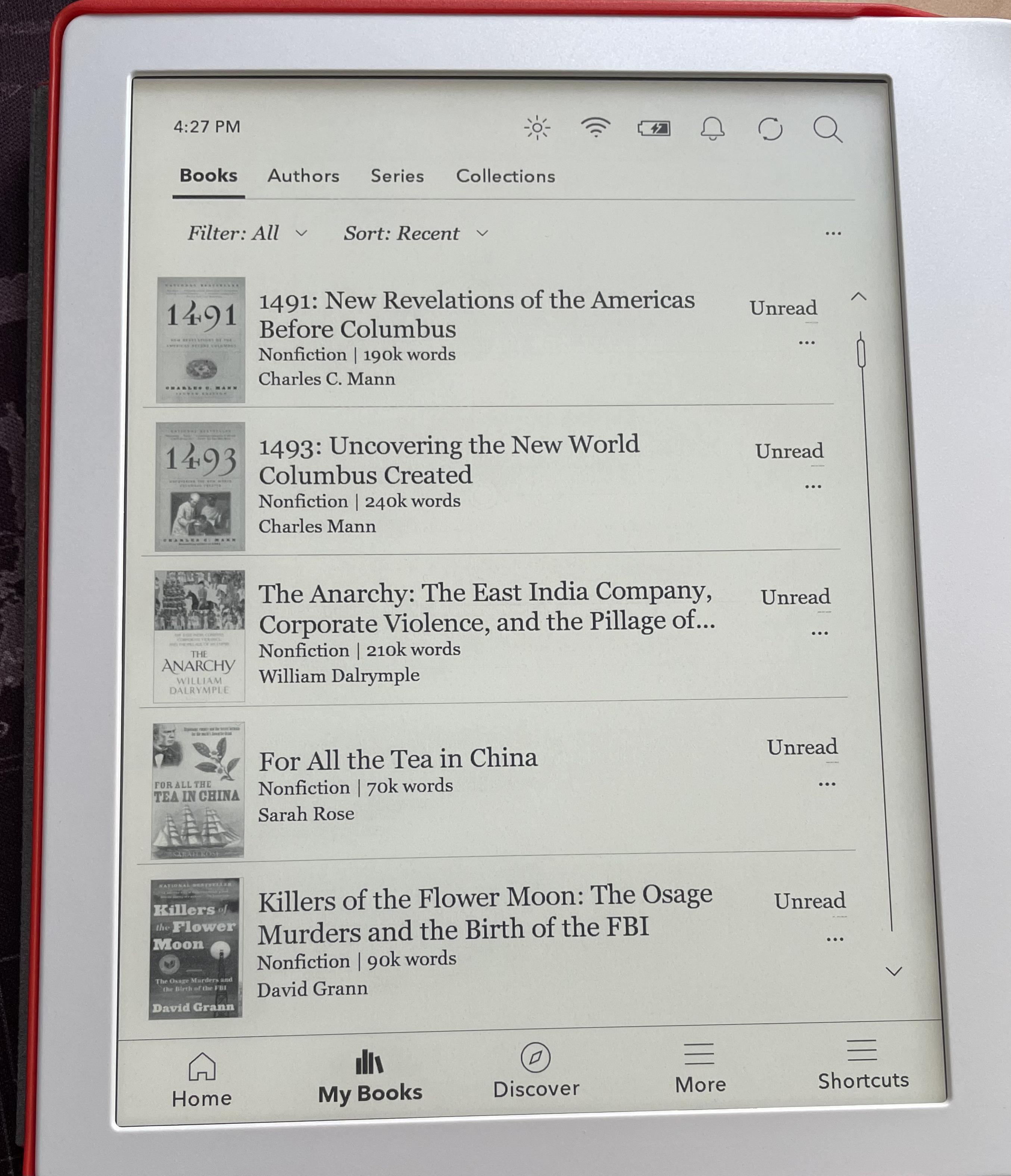

Ok, that's fair! I wasn't sure if my requests were simple to implement or more complex like you say.
Are there any resources/info for creating patches? The yaml files seem straightforward, but how do you know what to put under e.g. FindZlib or ReplaceZlibGroup etc? What files are these modifying? It would be fun to understand the process more - if it's too complicated for me to tinker with then at least it would be interesting to learn about

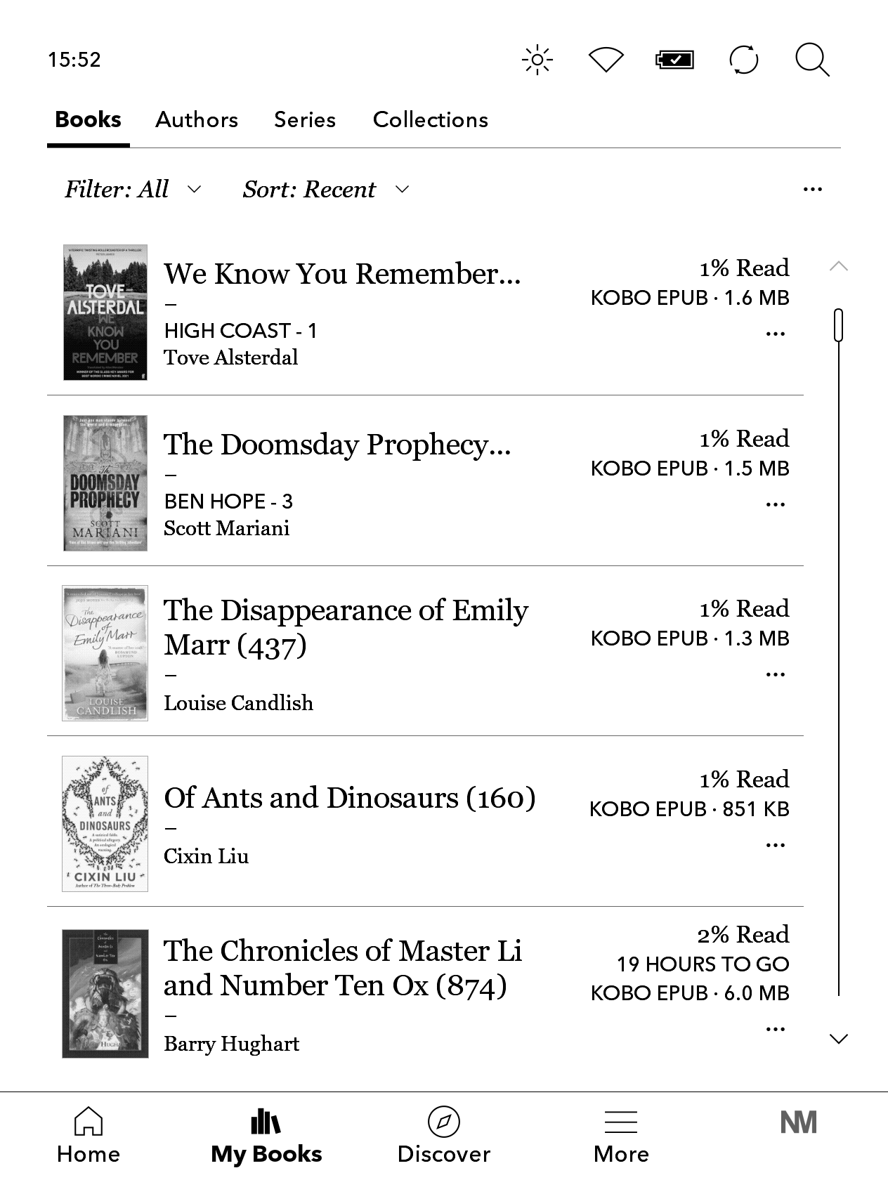

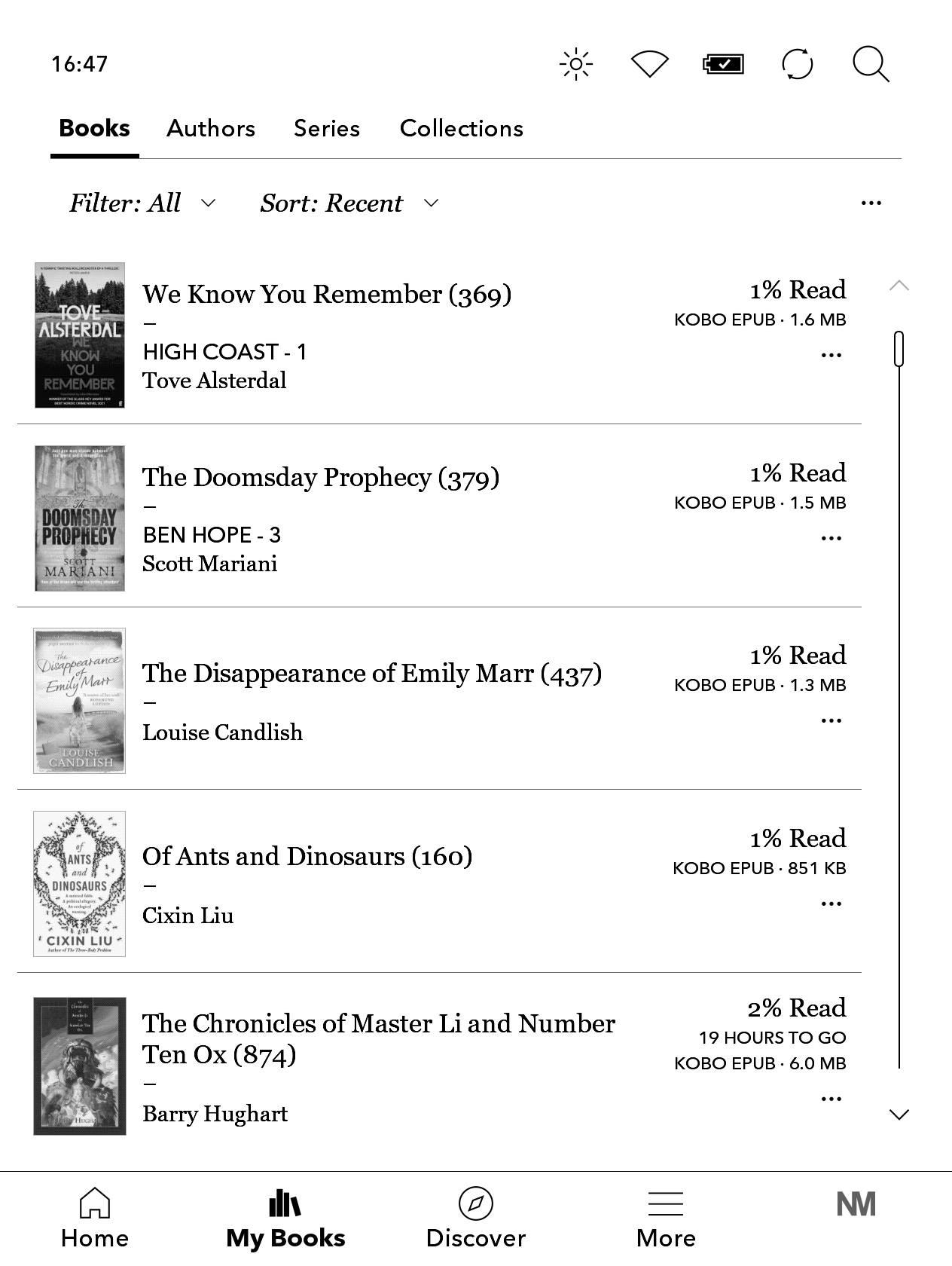

I've had a re-think. What you asked for would normally require 3 patches, each patch having settings for all the Kobo models. Instead I've combined all 3 patches into a single one, but only targeted at a single Kobo model group. The beta patch in the spoiler below should work for all Storm devices, i.e. LibraH2O/Libra2.
Have a look at the patch code to see if the included help notes are clear enough to be usable.
All Replace: lines can be customised as required. If that's too complicated simply enabling the patch will look like the 2nd image in the 2 screenshots (default vs. patched) attached below.
If the patch is considered both useable and useful on a Libra, I can look at creating similar patches for the other Kobo model groups. Feedback welcome.
Place the patch code in nickel.yaml (or wherever you keep all your other custom nickel patches).
'Storm' devices only (LibraH2O/Libra2)
beta Increase width available for book Title in Booklists - Storm only:
  - Enabled: no
  - PatchGroup: Booklist layout tweaks
  - Description: |
        Increase width available for book Title in GUI Booklists.
          - Part 1:     Customise font-size of book Title
          - Part 2:     (optional) Customise font-size of book Author(s) & Subtitle
          - Part 3:     Customise font-size of book Series and book (time remaining, filetype, filesize)
          - Part 4a/4b: Reduce large left/right margins in Booklists
        To get an idea of what effect this patch has, see screenshots at
            https://www.mobileread.com/forums/showpost.php?p=4239375&postcount=844
ID:	195014   Click image for larger version

beta Increase width available for book Title in Booklists - Libra only:
  - Enabled: no
  - Description: |
        Storm devices only (LibraH2O/Libra2)
          - Part 1:     Reduce font-size of book Title
          - Part 2a/2b: Reduce font-size of book (time remaining, filetype, filesize etc.)
          - Part 3a/3b: Reduce large left/right margins in Booklists
        N.B. Not suitable for users of Chinese-HK locale
  # Part 1: Reduce font-size of book Title
  - FindZlib: "HeaderSmallElidedLabel[localeName=\"zh-HK\"]," # default.qss (HeaderSmallElidedLabel)
  - ReplaceZlibGroup:
      Replacements:
        # Reduce Title font-size from 42px (default)
        # add Libra code by commandeering some code used only by ChineseHK locale users
        - Find:    "HeaderSmallElidedLabel[localeName=\"zh-HK\"],\nHeaderSmallItalicLabel[localeName=\"zh-HK\"] {\n  font-family: Sans-SerifZH-Traditional, sans-serif;\n  font-style: normal;\n  qproperty-forceLeading: 5;\n}"
          Replace: "HeaderSmallElidedLabel[qApp_deviceIsStorm=true] {font-size:35px;}"
  # Part 2: Reduce font-size of book (time remaining, filetype, filesize etc.)
  - FindZlib: "MetaDataAdjustingLabel[qApp_deviceIsStorm=true] {\n  font-size:" # default.qss (MetaDataElidedLabel, MetaDataLabel, MetaDataAdjustingLabel)
  - ReplaceZlibGroup:
      Replacements:
        # 2a: Reduce font-size of all 3 (MetaDataElidedLabel, MetaDataLabel, MetaDataAdjustingLabel)
        # Booklists (time remaining, filetype, filesize) use MetadataLabel
        # Reduce font-size from 29px (default)
        - Find:    "MetaDataAdjustingLabel[qApp_deviceIsStorm=true] {\n  font-size: 29px;\n}"
          Replace: "MetaDataAdjustingLabel[qApp_deviceIsStorm=true] {\n  font-size:23px;\n}"
        # 2b: Restore default font-size for book Series (MetaDataElidedLabel)
        - Find:    "MetaDataElidedLabel[localeName=\"zh-HK\"],\nMetaDataLabel[localeName=\"zh-HK\"],\nMetaDataAdjustingLabel[localeName=\"zh-HK\"] {\n  font-family: Sans-SerifZH-Traditional, sans-serif;\n  font-style: normal;\n  text-transform: none;\n}"
          Replace: "MetaDataElidedLabel[qApp_deviceIsStorm=true] {font-size:29px;}"
  # Part 3: Reduce large left/right margins in Booklists
  - FindZlib: "ScrollableContentWidgetBase[qApp_deviceIsStorm=true] {\n  qproperty-leftMargin:" # default.qss (ScrollableContentWidgetBase)
  - ReplaceZlibGroup:
      Replacements:
        # 3a: Reduce left margin gap between edge of screen and bookcover thumbnails
        # L-margin reduction approx. 6mm -> 2mm
        - Find:    "ScrollableContentWidgetBase[qApp_deviceIsStorm=true] {\n  qproperty-leftMargin: 67;\n}"
          Replace: "ScrollableContentWidgetBase[qApp_deviceIsStorm=true] {\n  qproperty-leftMargin:23;\n}"
        # 3b: Reduce right margin gap between edge of screen and book metadata when no vertical scrollbar present
        #     i.e. when Booklist page contains <=5 Book/Series titles or <=10 Author/Collection titles
        # R-margin reduction approx. 6mm -> 2mm
        - Find:    "ScrollableContentWidgetBase[noScrollBar=true][qApp_deviceIsStorm=true] {\n  qproperty-rightMargin: 67;\n}"
          Replace: "ScrollableContentWidgetBase[noScrollBar=true][qApp_deviceIsStorm=true] {\n  qproperty-rightMargin:23;\n}"
ETA: This beta patch is not suitable for kobopatchers who have set their Kobo locale to Chinese-HK. The space occupied by some of the Chinese-specific code was commandeered to simplify this patch for other users.

Originally Posted by allanahk View Post
Brilliant!!! Thanks very much, I've had a play around with the patch code to customise it to my liking and it's fantastic - a definite improvement in terms of using the list space more efficiently.
I've been tinkering a bit more with the beta patch settings and settled (for now) on the following:
- title font size unchanged
- file type/size font size = 1px
- margin gap as specified in patch code post
I've attached a quick photo of how it looks - it make a huge difference for long book titles and I really don't care at all about the file type/size info, setting it to 1px makes it practically invisible and allows for plenty of title space!
It also allows for longer subtitles - I use this area for genre and word count info (via calibre) and some of my fiction books can be in 4 or 5 genres making a rather long subtitle. Anyway I'm very pleased
allanahk is offline   Reply With Quote
Are these books from kobo store? I only have sideloaded books and the "Nonfiction | 190k words" are not shown on my kobo.
Can i make them appear via calibre?
