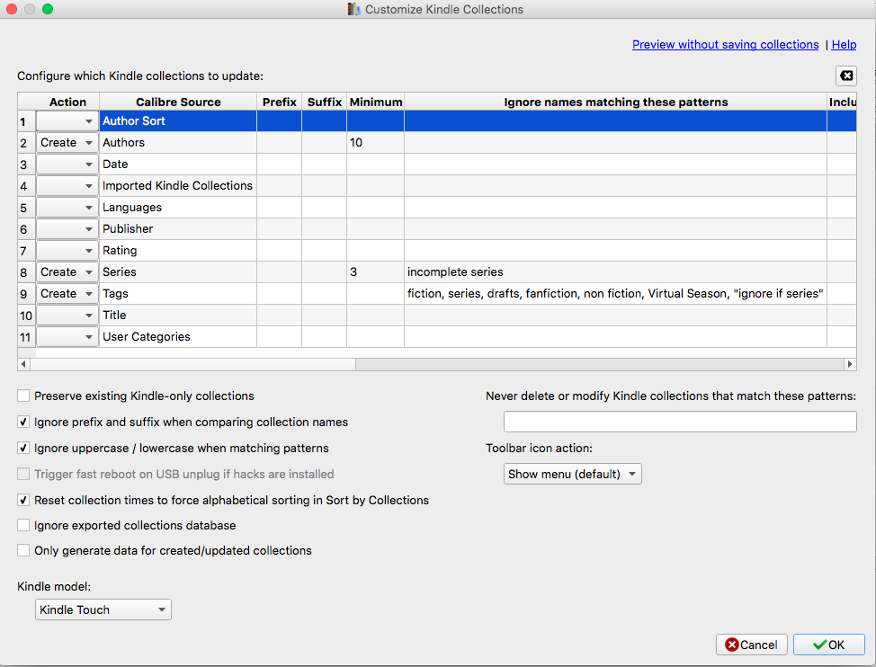

Old 02-13-2017, 06:08 AM   #1387
lorelaisquared
lorelaisquared began at the beginning.
Posts: 5
Join Date: Jun 2014
Device: Kindle Touch
Hi there,
I recently got Collections Manager loaded onto my Kindle Touch and I'm loving it so far. I used Calibre to do the big sorting but now I'm working on getting collections within collections and I've run into a snag. I had calibre sort my books that are series but those books were also tagged by genre (and I couldn't figure out how to get calibre to exclude them) so now they're in two places and I can't figure out how to remove them from the main genre folder.
For example, I have all of the books from the series "Anne of Green Gables" saved in a collection within the collection "Classics" but those books are ALSO in "Classics". I'd like to get it so they are only in the series collection but I can't figure out how to remove them from classics without moving them to another collection. I'm having the same issue with authors that were sorted into their own collections as well.
I've attached a screen shot of how I set it up in Calibre.
Any tips or suggestions would be great. Thank you!
Name:	Screen Shot 2017-02-13 at 03.12.22.png
Last edited by lorelaisquared; 02-13-2017 at 06:26 AM. Reason: adding a screen shot
lorelaisquared is offline   Reply With Quote

The screenshot is a picture of Calibre and your post states a problem with Calibre.
Try posting in the Calibre forum, somebody there probably knows the answer.
https://www.mobileread.com/forums/fo...play.php?f=236
Old 02-13-2017, 07:43 AM   #1389
lorelaisquared
Posts: 5
Join Date: Jun 2014
Sorry I think I wasn't clear. I have no way to take a screen shot of my kindle, so that's why I showed what I did in calibre before moving to my kindle hoping that would help. The calibre sort created duplicates I don't want and I can't figure out how to remove them from a collection using in the Kindle Collections Manager on my Touch. I can only seem to move them to another collection but I only want them in one collection.
Thank you for the link to the calibre forum though, I will post there as well in case there's a way to simplify things on the calibre end.
You have a touchscreen Kindle, you have a way to take a screenshot:
Touch two diagonally opposite corners (two fingers) at the same time.
Most likely cause: Collection Manager does not support nested connections on you device/firmware combination.
Check the first post and any readme.* document(s) in the package.
