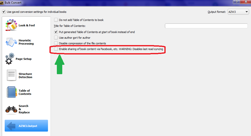

SOLVED IT!!
Ok this makes no sense to me whatsoever, but since it was working in the MOBI format I concluded that it was not my database or id's or anything like that and since I determined that it was also not any of my metadata templates, the only thing left that I could see left to try was the AZW3 output options.
I unchecked the option for "Enable sharing of book content via Facebook, etc WARNING: Disables last read Syncing"
reconverted to AZW3 --->send books to device ---> create collections from kindle collections ---> import collections from calibre via CM
Voila, success, collections now auto-populate with books in AZW3
No clue as to how or why this fixed it but it did.
Chrysandra

Ha ! Forgot about that... That setting strips the ASIN, which explains everything .
Why would that setting strip the ASIN? What is the purpose of that? I had only checked mostly just for sharing info with my mother. I never fully understood the option or warning. I actually never got it to fully work my books always said it was unavailable for that option.

@crissman: Apparently, for what it says on the box: make sharing work, at the expense of sync.
Possibly, if your book comes from Amazon, and thus has a valid ASIN, sharing would work. I've never played much with this side of things, but that would mirror the thumbnails behavior, so it's not completely out of the realm of possibilities...
Yeah most of my books are not from Amazon. So I guess this makes sense if this option requires a ASIN to work.
