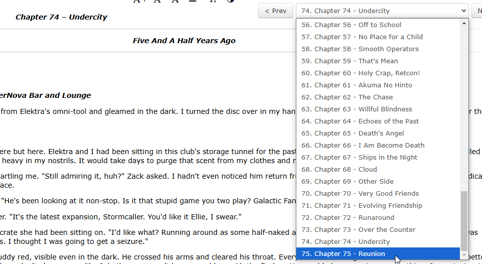

ffnet question How do I get a new chapter when ffnet is fucking up and it doesn't appear in the TOC for chapter 1? I tried using chapter page directly but it didn't work and says only 74 chaps. Is there a way to override where it gets the links?
https://www.fanfiction.net/s/1288375...-Transcendence
Name:	2025-03-02 16_59_50-Mass Effect_ Transcendence Chapter 1 - Do No Harm, a mass effect fanfic _ Fa.png

Name:	2025-03-02 17_00_08-Mass Effect_ Transcendence Chapter 74 - Undercity, a mass effect fanfic _ Fa.png
EDIT: And Chapter 75 is gone again. What is wrong with this site.
You can try check_next_chapter and meta_from_last_chapter.
## ffnet used to have a tendency to send out update notices in email
## before all their servers were showing the update on the first
## chapter.  It generates another server request and doesn't seem to
## be needed lately, so now default it to off.
check_next_chapter:false
## ffnet sometimes doesn't update the metadata on the first chapter
## immediately.  meta_from_last_chapter:true will instruct the adapter
## to take the metadata from the last chapter instead of chapter 1.
## It can generate another server request and usually isn't necessary,
## so it defaults to off.
meta_from_last_chapter:false
Beyond that, broken site is broken.

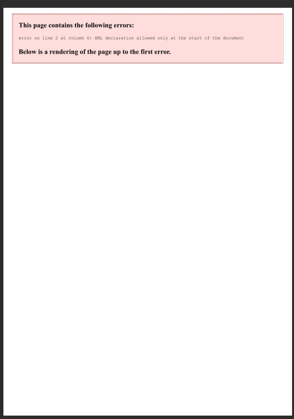

Hi Jimmy, can I have your help? I looked at this https://github.com/JimmXinu/FanFicFa...Calibre-Plugin and it's not really helping me figure out my problem.
So, when I try to use fanficfare with the generate covers plugin, I get that screenshot below. Something about an error on line 2 at column 6: XML declaration only allowed at the start of the document. But, when I just use the generate covers plug in and press that, it generates the cover.
Can you please help me figure out why fanficfare is not working with the generate cover? I couldn't find anything in my personal.ini for it. and it's on the default cover.
Thank you!

Without seeing the epub (or at least the story URL) and GC settings involved, no, I can't tell you anything about it.
