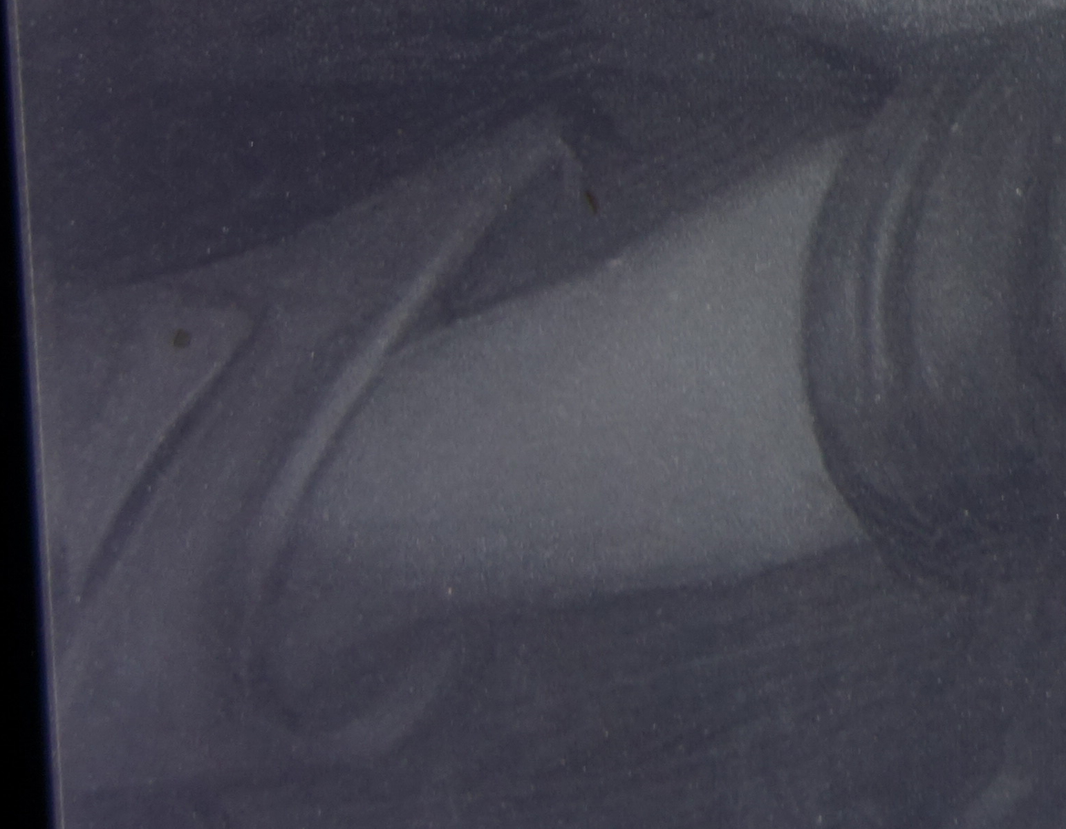

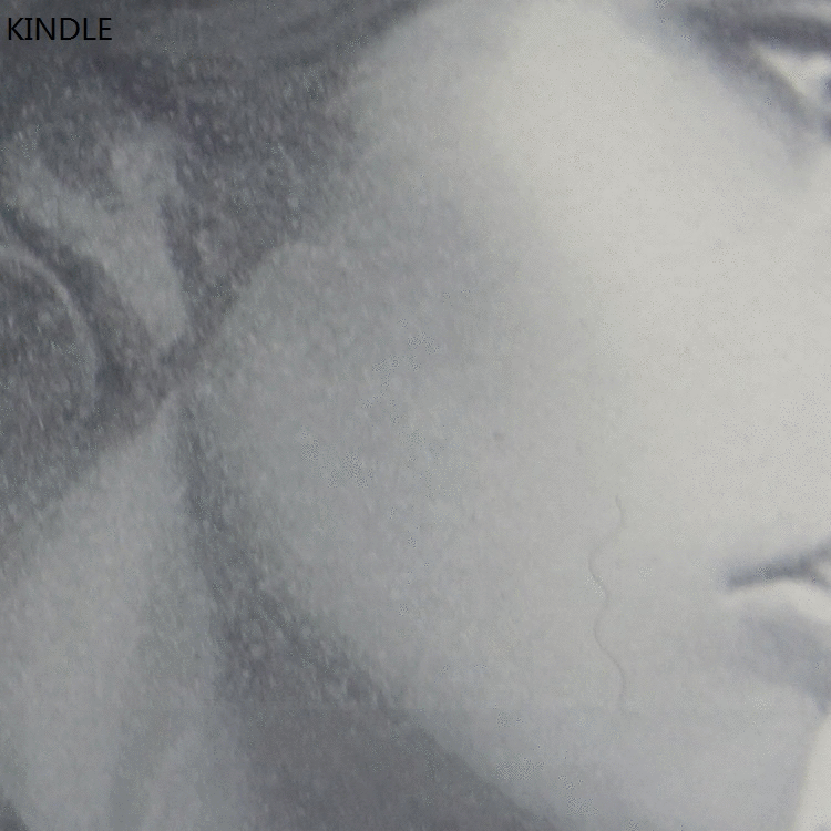

have a problem with image display
differential between the same picture displayed in kindle native and koreader on my kindle voyage.
it seems like koreader use less color depth ,
but screenshot of the picture in koreader is perfect,
so i dont think it is a render problem.
more detail(click to zoom):
koreader
is it normal?
Most likely, "normal".
How about giving some technical details, such as produced by the ImageMagick toolset.
(See: FGA, #10, troubleshooting links)

i didnt delete it , its still in attachments.
u answered me in the next reply , so i thought anyone can find the solution quickly.
but ok,maybe i should post it:
i used imageMagick to convert pictures , the command sloved problem was found in here
for file in *.png ; do ; convert ${file} -filter LanczosSharp -resize 758x1024 -background black -gravity center -extent 758x1024 -colorspace Gray -dither FloydSteinberg -remap ~SVN/Configs/trunk/Kindle/Touch_Hacks/ScreenSavers/src/linkss/etc/kindle_colors.gif -quality 75 -define png:color-type=0 -define png:bit-depth=8 dithered_${file} ; done
There is the missing piece of information - -
That was an image you had created yourself.
I first had read that as if it was an image in a book (since you only mentioned using two different readers to display it).
