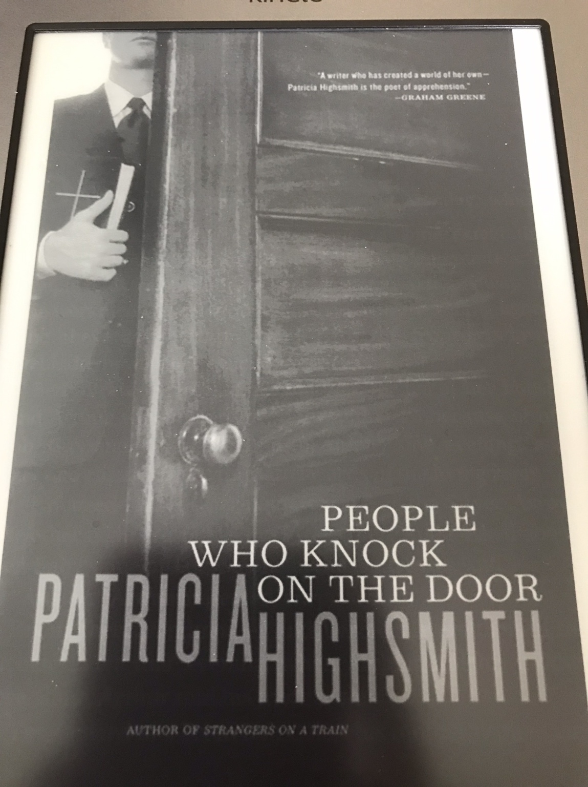

I just set up the COVER screensaver hack successfully! It took me a few tries, and I think it would be a good idea to clarify that the 'blank file' named 'cover' should be created by copying the 'DONT_HALT_ON_REPAIR' file and renaming it 'cover' then moving it to the linkss folder.
This is because I didn't understand that a 'blank file' meant a 'blank executable file' and I tried and failed many times with a blank txt file.
And when I look back over the years that I have tried various hacks on my previous kindles, I do remember never getting this to work, and that is why! So, maybe spell this out in the first post?
Anyway, I'm very pleased with it, so thanks very much!

@Pjama: The whole shebang kinda got "fixed" by just recommending doing that via KUAL, because then it's just "click a button", and it does the right thing .
Otherwise, the exact instructions would heavily depend on the OS, the file manager, and how it's setup, which can quickly get hairy .
Oh, I see, I’m doing it freestyle, without KUAL.
