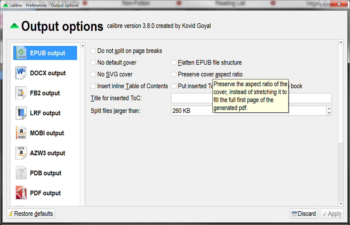

I just had a look and the tooltip for "insert or replace cover" doesn't mention PDF It does mention ePub.
"If a cover page is identifiable in the epub then it is replaced otherwise a new cover page is inserted"
I'm not sure where you're looking but the tool-tip for "Preserve cover aspect ratio" does refer to PDF, see attached.

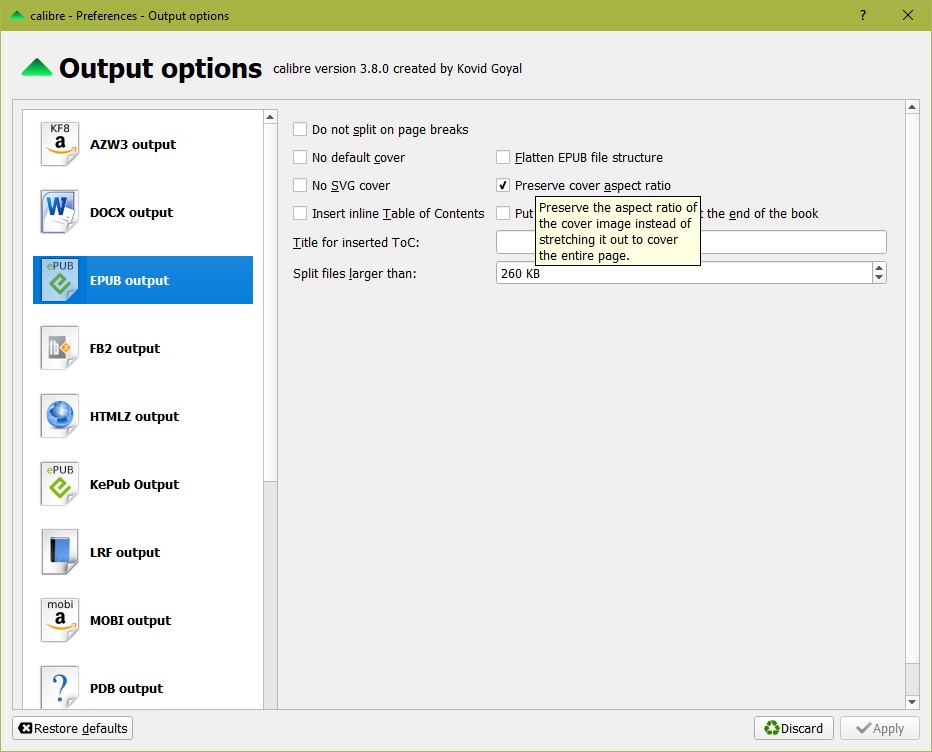

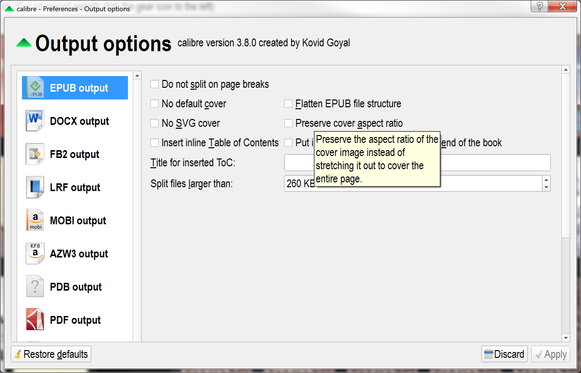

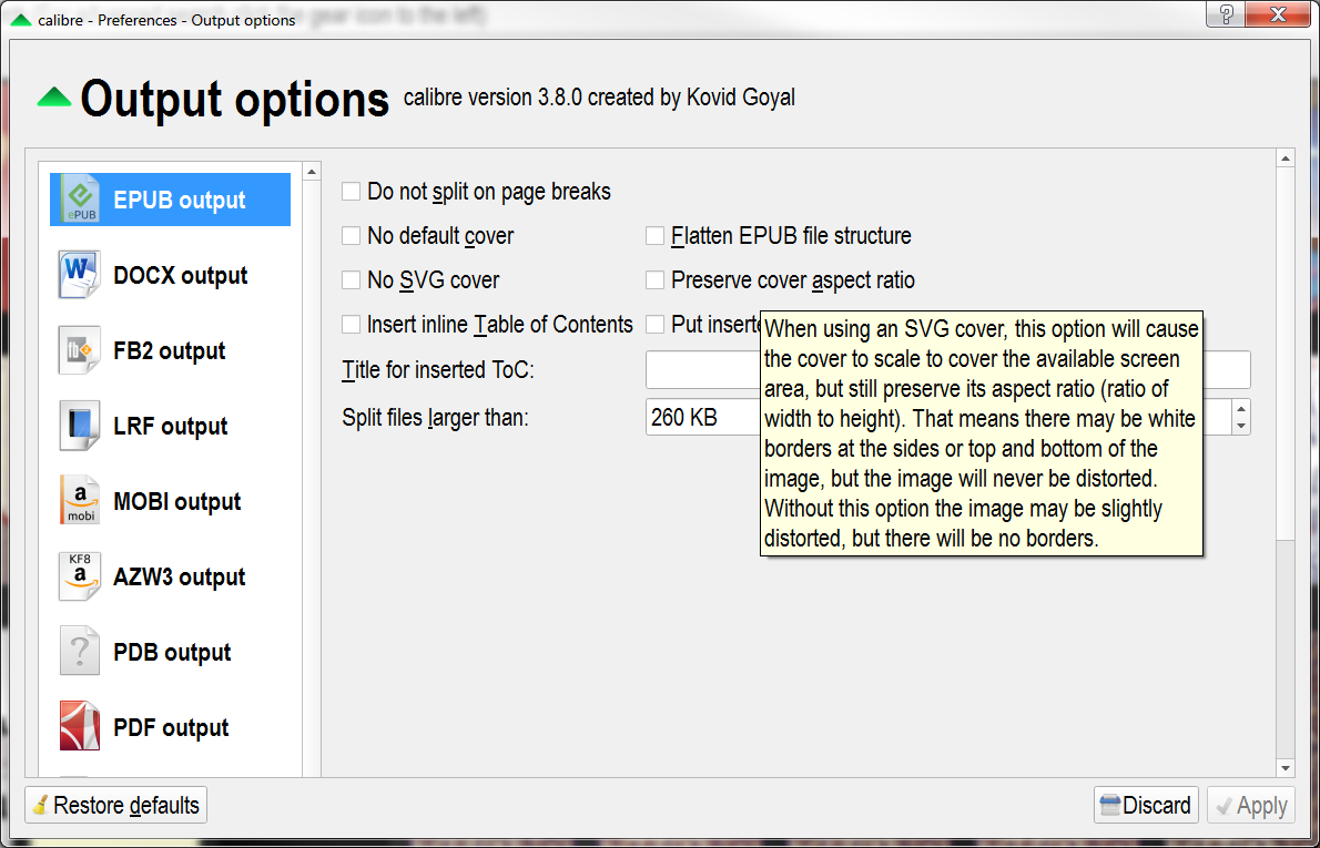

I was talking about the tooltip in Modify ePub. But, I don't get a tooltip in Calibre about PDF.
I just messed around and I have actually seen 3 different tooltips for the Preserve cover aspect ratio under EPUB output options. See attached. I haven't been able to consistently figure out when and why they change but there they are.
Mine is Calibre Portable 3.8.

Old 10-03-2017, 09:20 PM   #1108
jhowell
jhowell's Avatar
Posts: 7,163
Karma: 92500001
Location: Charlottesville, VA
Device: Kindles
It might be related to this not yet released calibre bug fix: Fix incorrect help strings being used in Preferences->Input/Output Options when multiple formats use the same option name.
