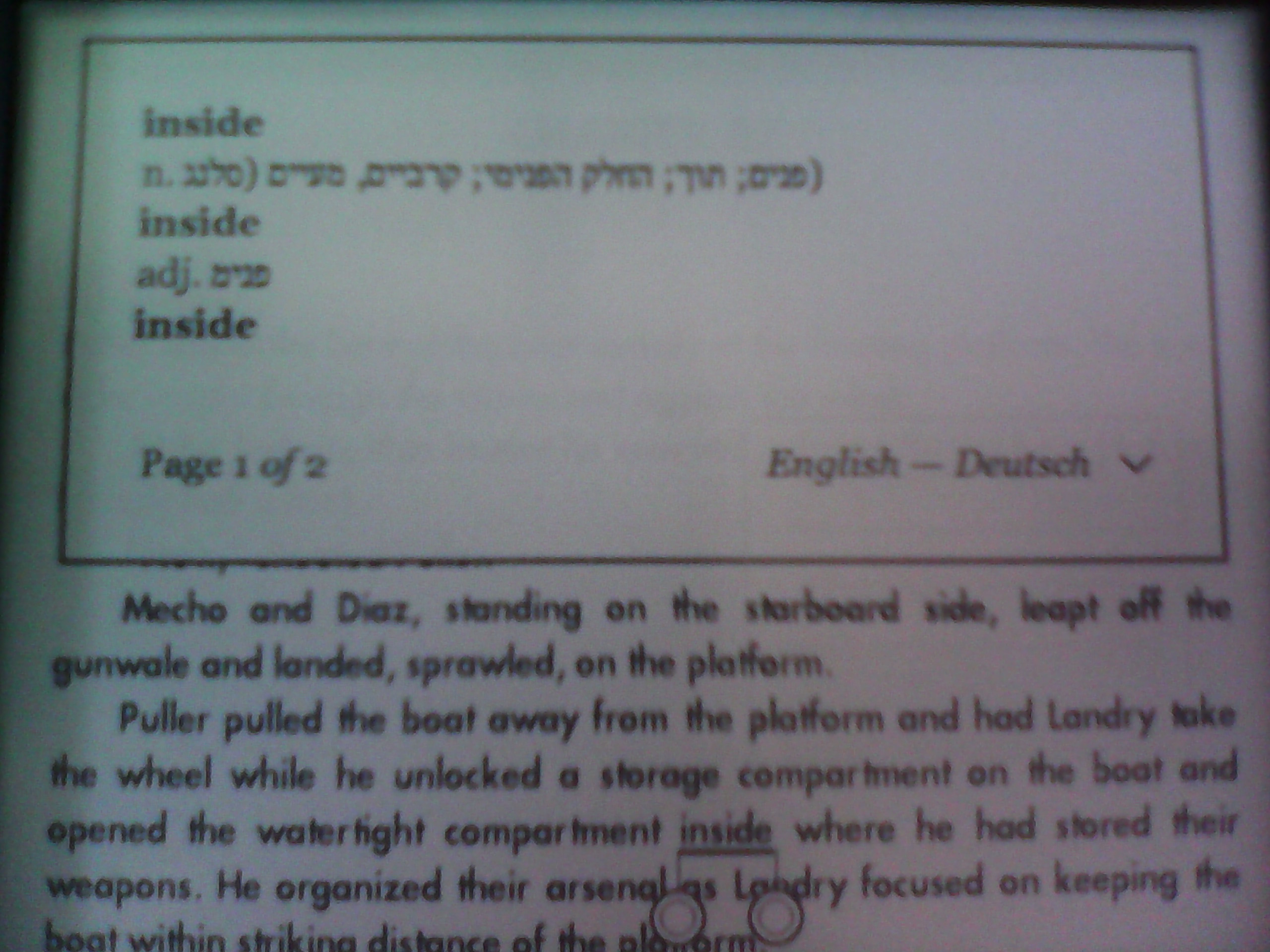

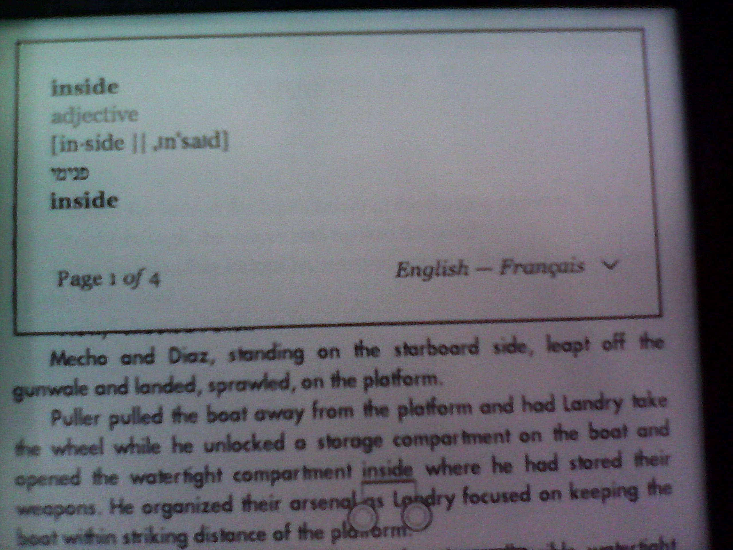

Hi AlPe
I make English-Hebrew dictionary whit penelope3.py file but the last letter not showing.
it happen if there is n.(noun) or adj. before the translation.
ID:	142431   Click image for larger version

Hi,
I assume no error/warning is printed on the console when you run penelope3.py .
Try outputting to CSV (`--output-csv` instead of `--output-kobo`), open the file with a text editor, and see if the last letter is missing.
If so, it is a parsing problem in penelope. If possible, please email me the input dictionary, I will have a look.
If not, I guess it is a problem of the Kobo firmware.
