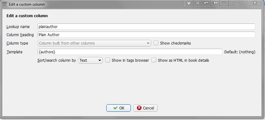

I don't know if here is the place to ask but is there an option to sort the authors or titles on the field (ie not the "author sort" or "title sort" but what is in the field?)
I don't want this all the time, but I would like the option to switch to a "normal" view vs the standard "sort" view.
When checking a list of files (books) or a directory of books it is almost always in the normalized order of first name last name. It would be much faster to check if I could switch between sort order views.
For the life of me I can't figure out how to do this

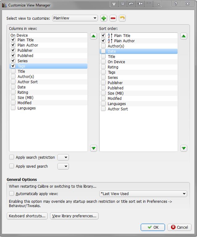

@Inferno - I have Plain Title and Plain Author columns. Most of the time I don't show them, but I have a Plain View that shows them as a Plain List as and when needed See attachments

I tried the View Manager for the first time and had to redo my column view by hand to get it the way I always use it lol. Not used to this plugin for sure.
I have created the alphaauthor column based on authors. Now, I am not used to this but am I right in thinking this means that changes I make to the authors field automatically changes the alphaauthor column?

@Inferno - Columns built from other columns (virtual columns) are created as needed from the source column(s), hence changes is the source column(s) are immediately reflected in the virtual columns.
Test: show the Author and the Author Alpha columns in the book list, F2 on an Author cell, change it, hit enter, the new value will be reflected in the Author Alpha column.
The disk space is trivial. A few hundred bytes in the database for the virtual column and view definitions, similarly in the metadata_db_prefs_backup.json file.
