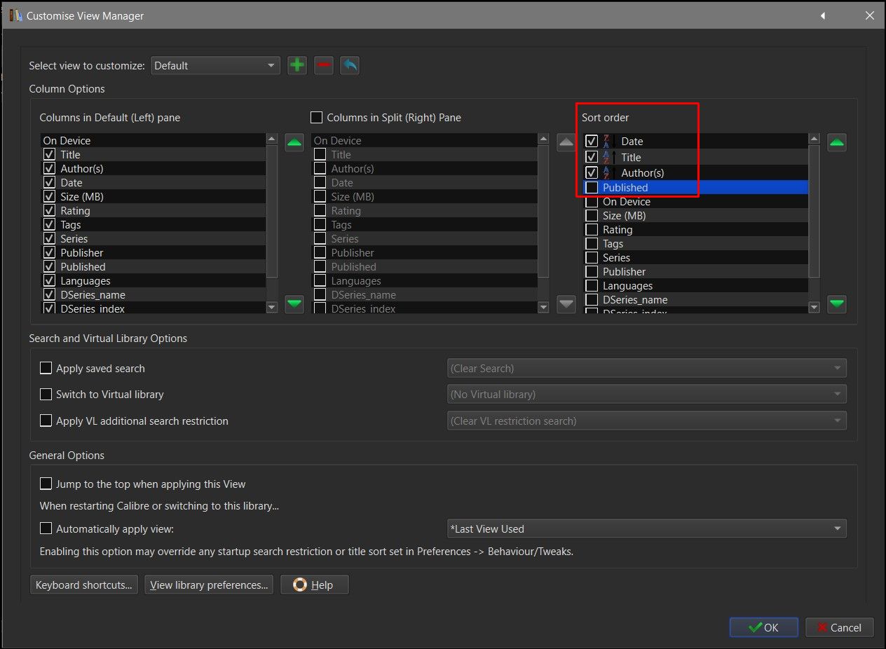

Old 12-16-2022, 05:33 PM   #384
Posts: 22,009
Karma: 30277294
This may have been raised before.
The sort direction icons are very hard to see in dark mode, see attachment.
Name:	Screenshot 2022-12-17 083612.jpg
Old 12-16-2022, 05:50 PM   #385
ownedbycats
Custom User Title
ownedbycats's Avatar
Posts: 11,337
Karma: 79528341
Join Date: Oct 2018
The github had XCF (gimp file format) with lighter arrows. I exported them to .png for you.
Old 12-16-2022, 10:11 PM   #386
Posts: 22,009
Karma: 30277294
Thanks, but for me they're worse, I'll go with these for now:
Name:	Screenshot 2022-12-17 140852.jpg

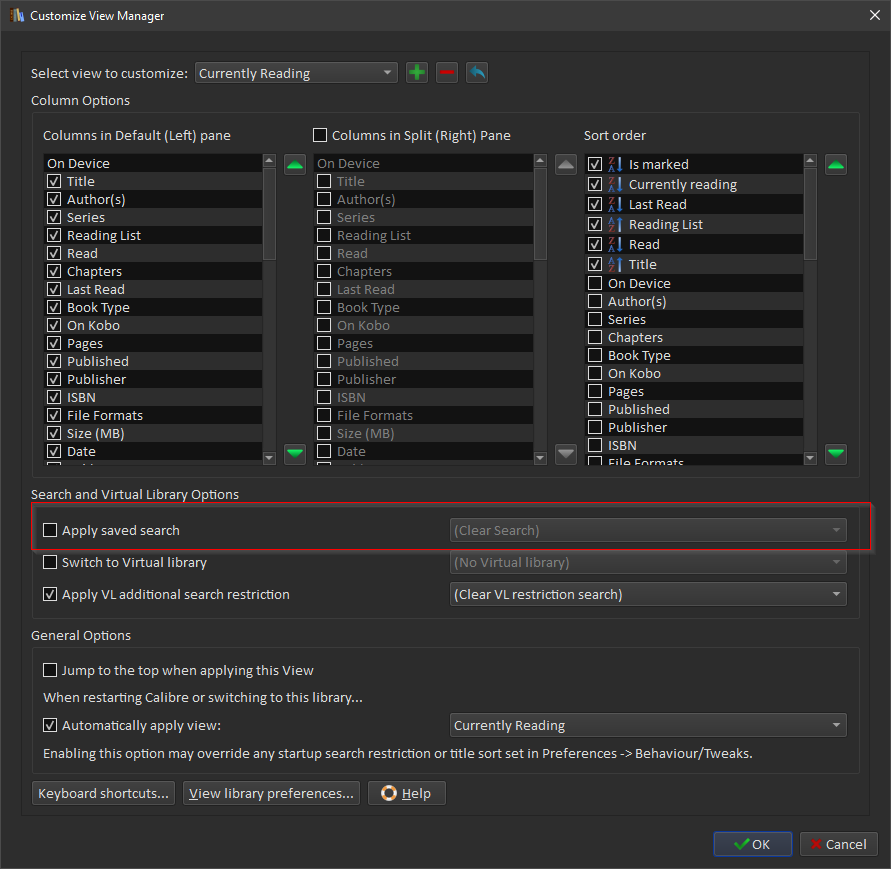

If I use the Re-apply current view action when there's an active search, (e.g. authors:"=Tim Winton") the search is discarded. I use the Re-apply… action after moving a column, showing a column, sorting on a specific column etc.
I'm sort of surprised I only just noticed it. IMO the search should be retained… or reinstated.
Old 12-18-2022, 11:00 PM   #388
ownedbycats
Custom User Title
Posts: 11,337
Karma: 79528341
Join Date: Oct 2018
That doesn't happen to me unless the view is set to clear the current search.
Name:	2022-12-19 00_00_51-Customize View Manager.png
Old 12-18-2022, 11:55 PM   #389
Posts: 22,009
Karma: 30277294
Inexplicably I had Switch to Virtual library checked and (No Virtual library) set. Hunky dory now I've I unchecked it.
Aah-ha now I see why. The Search and Virtual Library Options are per-library settings, my other libraries. . . where I'm more likely to use the Re-apply… action. . . have all three options unchecked.
Thanks for the tip.
