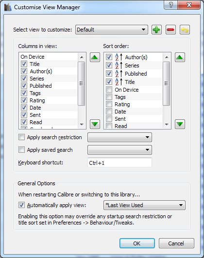

v1.0.5 Released
Changes in this release:
  • Fix bug of not always remembering the last applied view when restarting/switching libraries
  • Enhance configuration options to allow specifying a view to apply at startup
  • Ensure any auto applying of views is a per library setting
@Nyn - this should hopefully address the bug and feature request you made above. As you can see from the new screenshot you can choose to do nothing (default, checkbox is unchecked) or to automatically apply either the "*Last view used" special item at the top of the dropdown combo, or one of your named views.
Note that just like the views themselves this is a per library setting.
