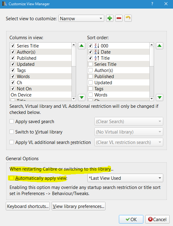

@BR - As we discussed last time (not trying to belabor the point--just documenting it as I remember it), saving the sorts that are currently in effect is what I think it should do.
You can always explicitly set your sorts by editing the View in the config dialog. You can even clear the sort history by using a View with no columns selected in sort.
@Terisa de morgan - Yes, to clear a search/restriction/VL when selecting a new View, you check the Apply checkbox while leaving the dropdown empty in that View's config. That's the existing behavior, my changes don't effect it (except for adding VL, of course).
To me, that's the desired behavior. If I have a search/restriction/VL up and I switch between my 'Wide' (for full screen) and 'Narrow' (for everyday use) Views, I don't want those changed. For people who do, that's why the checkboxes are there.
Would it be better if there was text explaining that in the tooltips? Or even a new label?
I'm unaware of any case where VM could modify an existing search. It should only replace it or leave it.
Thanks to both of you for your interest and input.
My usage of VM is strictly set-and-forget, never occurred to me that folks would use the configuration as 'interactively'.
Rather than going into configuration to 'clear' a SS, VL, or ASR selection, would it be better to have a Clear current selection option in the plugin's drop down menu. It could avoid the confusion I had.
Clear current selection->Saved search
                         Virtual library
                         Additional search restriction
Many people don't read or can't 'get' the tooltips. When warranted I copy them into the clipboard (via Textify) so I can read and re-read until I do 'get' it
I'll re-brand the current version as Book List Manager and stick with it.

While swapping out the 'apply' checkboxes for new "Don't change" and "Clear" options in the dropdowns would maybe be less ambiguous, it would be either non-backwards compatible or bend over backward for backwards compatibility.
I don't think it's that confusing to want to do either.

@JimmXinu - you're right it's too late, I never used the existing SS and ASR options, so I'd forgotten the check boxes were even there.
The check box and selectors should at least have different tool tip text, that they were the same is what confused me. Maybe put a heading above the check boxes and selectors, something like 'Clear' (if that's what they're for) and 'Apply'.

I tried using the plugin on a different library and got the following error:
calibre, version 2.70.0
ERROR: Unhandled exception: <b>UnboundLocalError</b>:local variable 'apply_virtlib' referenced before assignment
calibre 2.70 [64bit]  embedded-python: True is64bit: True
Windows-7-6.1.7601-SP1 Windows ('64bit', 'WindowsPE')
('Windows', '7', '6.1.7601')
Python 2.7.9
Windows: ('7', '6.1.7601', 'SP1', 'Multiprocessor Free')
Successfully initialized third party plugins: Count Pages (1, 7, 0) && Import List (1, 1, 5) && Generate Cover (1, 5, 21) && User Category (1, 5, 3) && Save Composite Custom Columns (1, 1, 0) && Reading List (1, 6, 6) && View Manager (1, 4, 2) && FanFicFare (2, 12, 3) && Find Duplicates (1, 6, 2) && Edit Columns (0, 0, 1) && Tanja's Tools (0, 0, 6) && MultiColumnSearch (1, 0, 69)
  File "calibre_plugins.view_manager.action", line 280, in show_configuration
  File "site-packages\calibre\customize\__init__.py", line 155, in do_user_config
  File "calibre_plugins.view_manager.__init__", line 62, in config_widget
  File "calibre_plugins.view_manager.config", line 490, in __init__
  File "calibre_plugins.view_manager.config", line 564, in select_view_combo_index_changed
UnboundLocalError: local variable 'apply_virtlib' referenced before assignment

Test version with:
  • Fix for new-used-before in library.
  • More disambiguation of settings.
Last edited by JimmXinu; 05-12-2018 at 12:57 PM. Reason: Remove obsolete test versions

Test version with:
Soooo..... The additional disambiguation--improvement or more confusing?
@JimmXinu - my feedback
I think it's better, but as previously indicated I will be using the old version, so my opinion doesn't count. TdeM indicated in another thread she would be away from her calibre machine until Friday.
Don't know what this is, so can't comment.
Ah-ah - I guess it's the problem reported by Tanjamuse.
Sorry, I'm not a lot of time at my computer out of work now and I had missed this. The concepts are quite clear for me now, with the new wording.
Just a question, is there the possibility of translating this plugin? As I'm using quite a lot now, I would like to translate it to Spanish if it is possible (A peeve of me but...)

Thanks!
Translation is possible, but it's a bit more than I want to attempt just now.
Unless there are any other concerns left, I'm going to ask Kovid to release this version.

Originally Posted by Inukami View Post
In other words, if I want to see my particular columns for a Virtual Library I need to use only the View Manager plugin because if I click on the Virtual Library instead it won't show the correct columns.
You can also configure View Manager to apply a particular view when you change to a library:
