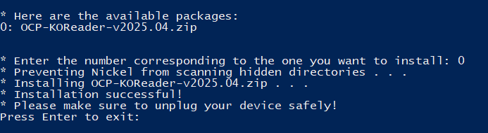

I have a brand new Kobo Clara BW 4.41. I tried to install koreader with one-click method, but koreader doesn't open.
I did everyting accordingly. Put the ocp.zip and install.ps1 (unblocked) in the same folder, run with powershell. After installation, I safely unplugged the device.
Ah, one question here: everytime I eject the device on Windows, it appears that the device was succesfully ejected, but on kobo it looks as if it is still mounted. So I have to unplug so it can show the update screen. Is that normal?
Then, I click on koreader on NickelMenu, but it only restarts the device. The same happens when I click on koreader on My Books.
I tried several times, I did the real factory reset through developer options.
I heard that some people owning clara bw with the latest firmware are having some issues to that regard, is that true?
Could you help me with this situtation? I only get Kobo to have Koreader
Jwing is offline   Reply With Quote

Unmount is so that it's safe to unplug. The device only knows about unplug.
You can check in the KOReader directory if there's a crash.log and if it says anything. If not then it's not being started.
If that doesn't work you can check the syslog for NickelMenu logs, but that's a bit more complicated.
