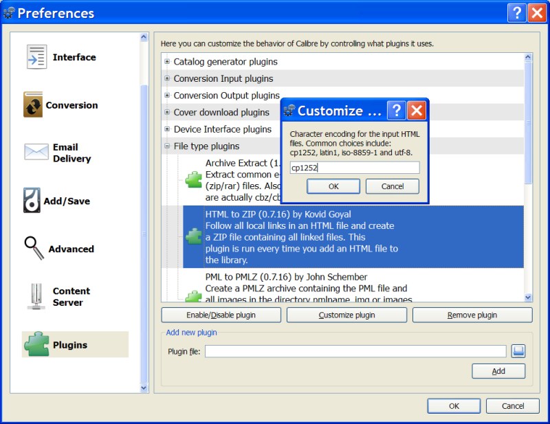

This is a character encoding problem that has to be adjusted in a plugin prior to adding the book. Read this section of the FAQ. Calibre attempts to figure out the proper encoding of a html file but sometimes you have to enter the encoding into the plugin manually, then re-add the html to calibre (see attached).
Encoding you might try cp1252, cp1251, latin1, iso-8859-1, utf-8.

Going into the plugins and changing it to cp1252 worked perfect... Thank you so very much!

Don't forget to change it back to blank or it will bite you again for forcing it to assume everything is cp1252.
