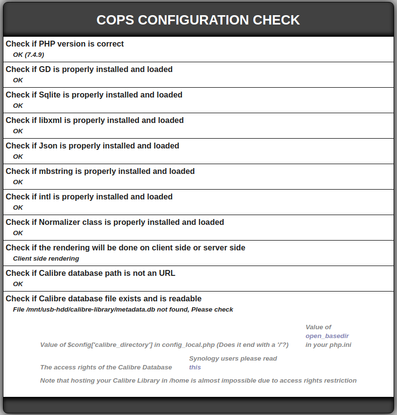

@cbalmforth
What is the output of:
http://<Pi-ip>/cops/checkconfig.php

Sorry for the late reply. I've attached screenshots of the checkconfig.php output and a listing of the directory containing a test library. COPS works fine if I move this directory to /home/calibre-library/

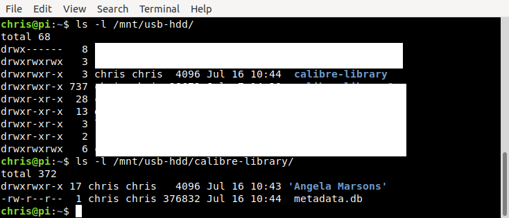

Can you do:
ls -l /mnt/usb-hdd/
and
ls -l /mnt/usb-hdd/calibre-library/
I do not run Ubuntu on my Pi, so first checking the rights setting, the most common problem.

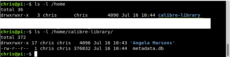

Thanks mariosipad. I've attached screenshots of the directory listings you requested, and also of the directory where COPS works. I blanked out the other directory info!

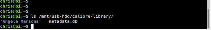

I had high hopes for the symlink but unfortunately it has the same result. I created a soft link named calibre in the /home directory, and ls /home/calibre/ correctly lists the library directory including metadata.db, but I get the same checkconfig error. Changing permissions to 777 also had the same result.
Many thanks for all your help, but I've decided to stop wasting everybody's time and live with having the calibre library on my system disk and not the external usb hard drive. Maybe I'll take another look when the system disk starts running out of space!
