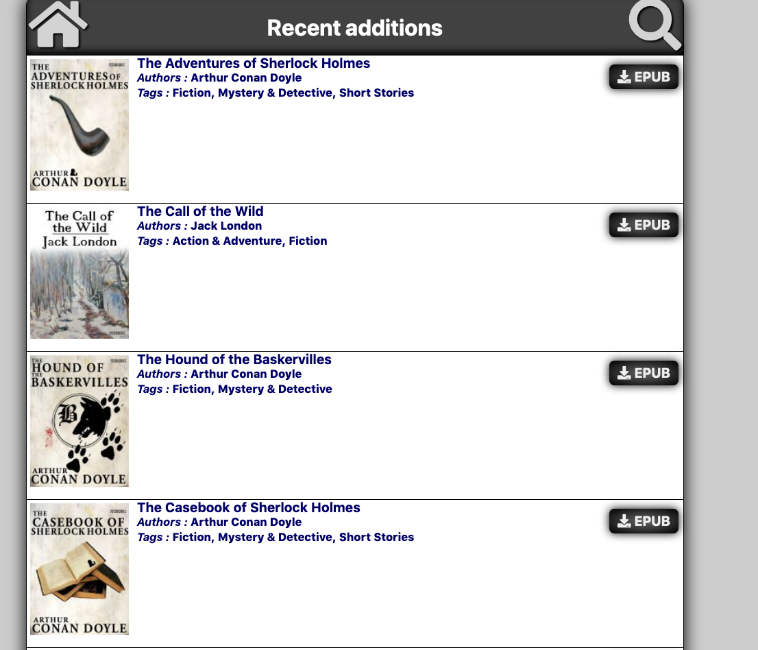

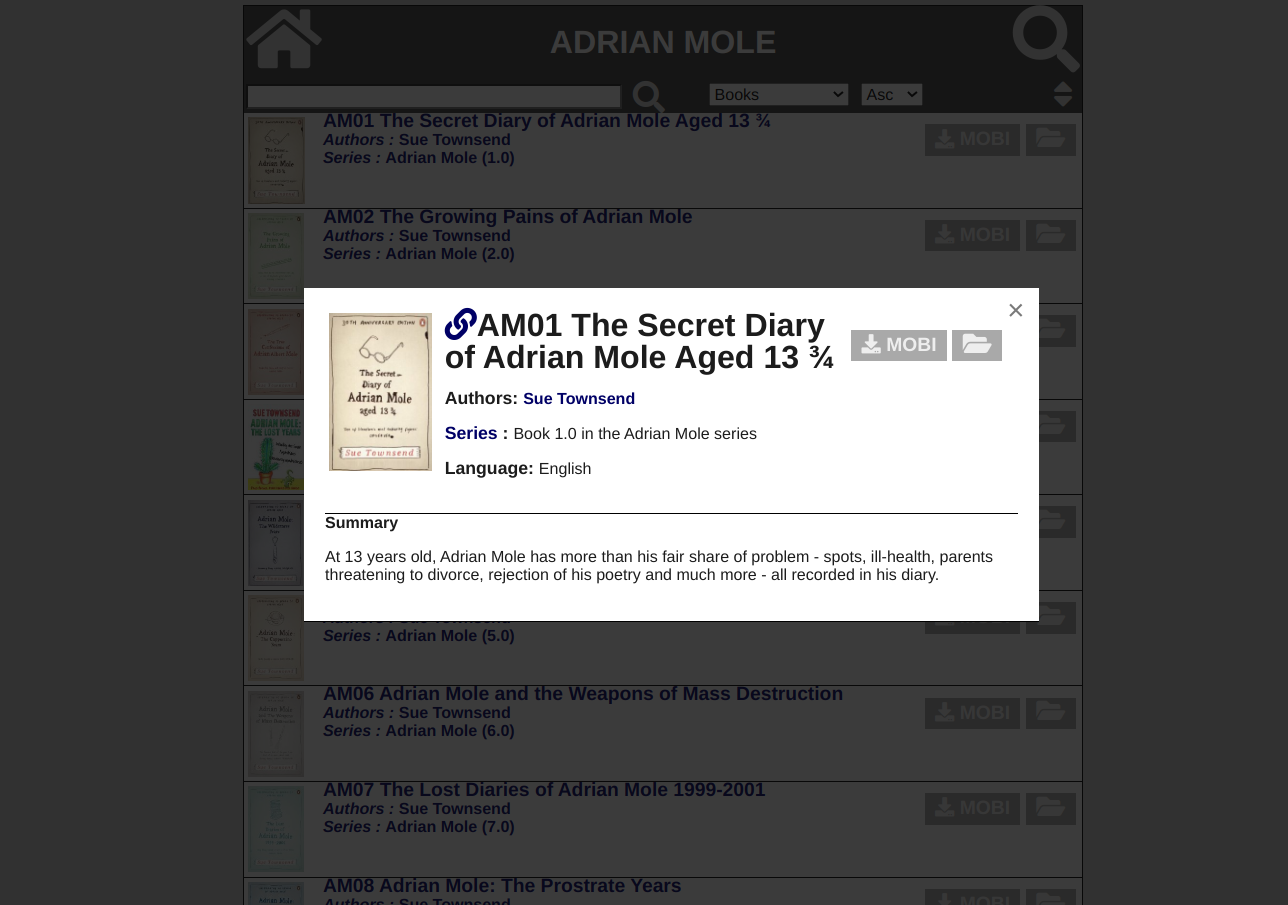

@cbalmforth
1 - the "eye" icon
You will only see the "eye" icon (see picture1) if it's an EPUB-file, not if it's a MOBI-file.
