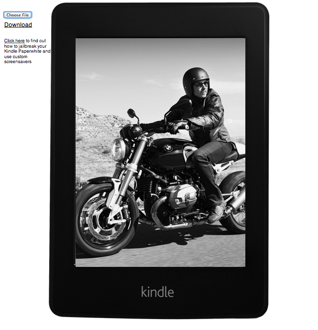

Just created this custom screensaver creator for the Touch and Paperwhite 2 (and any other kindle that can use 758 x 1024 or 600 x 800 screensavers). Click the link on the left to toggle between paperwhite and touch.
Select a large jpg or png, and it lets you zoom and crop and convert to black and white, then right-click to save as a black and white PNG.
Everything takes place on the client-side so nothing is uploaded.
Please let me know if you have any feedback or questions.
https://crowned.github.io/kindlesaver/

@crowned It would be really cool if one could use link as image source!
Never thought of that. I'll see what I can do (just when I thought I was finished with this sucker!)
