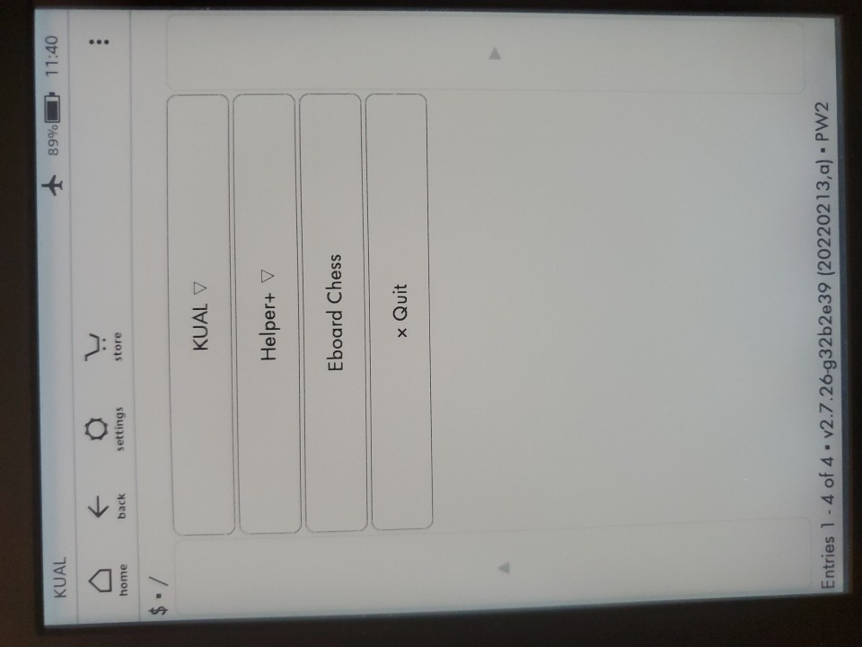

Could not install Python
Hi,
on my jailbreaked PW2 I did install KUAL
but installing Python will be refused
Update error - invalid update file
Any hints, thanks in advance
