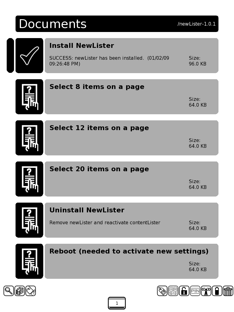

Hello Developers,
I've assembled an installer for the improved contentLister (with more items on a page).
  • I've tried to make this robust and safe
  • The menu enables to install, un-install an set the number of items on a page
  • the program itself is the same as last time (with a repaired cursor, thanks ericshliao)
  • I've started a new thread for this because the install procedure and attachments are new. For some background: see the old thread (https://www.mobileread.com/forums/showthread.php?t=34889)
  • Install: just unpack the bin-tgz on on a memory card, navigate to it and run the installer.
  • Sources: for those who want to compile themselves: use the src-tgz: after unpacking this can be compiled in the same way as the original Irex contentLister (build_from_scratch.sh...)
Happy new year!
Hansel.
EDIT 6-jan-2009: version 1.0.3. Install scripts no longer get in 'Recent Documents'. In the previous version this caused some Iliads to reboot endlessly. Sources have not changed.
EDIT 8-jan-2009: version 1.0.4. Install scripts now accept all firmware versions with 2.12 in it (book edition has 2.12.1)
EDIT 21-feb-2009: If you have a modified start-up script, you may have to set-up things manually. See Haven's post further in this thread (post 53)
EDIT 23-mar-2009: newLister 1.0.5: Minor update to ease the 'Iliad OS'. No need to upgrade.
  • NewLister tries to read the nr of items on a page from /mnt/settings/newLister. It expects one line with just a number. This value can be overruled on the command line.
  • Tweaked layout a little: a bit less spacing, a bit more room for the text.

I've just installed your newLister, and it works like a charm!

Installed to mmc card, did not choose number of items and tapped reboot this resulted in a continuous reboot.
Took out both mmc and cf cards and rebooted no problem.
Replaced both cards rebooted no problem chose 12 and rebooted again works
superbly a great addition for me.
Thanks

Installed to mmc card, did not choose number of items and tapped reboot this resulted in a continuous reboot.Thanks
hello ne14st,
No idea why it kept rebooting the first time?!?! Also, it should have made no difference when you removed the cards: the program is installed to internal memory, and the stuff on the card is only needed to install or change settings. Did you have any modifications in your start script or was it the original one? Could you have a look at the _install.log file (on the mmc, in the installation directory) to see if anything special happened?
Thanks for reporting!
PS: installing without specifying a number of items should display 12 items on a page (the default)

Start script was default and had never been altered. I described exactly what happened I have had no problems since and I am super satisfied.
Have changed listing numbers to try all but have settled on 12.
It would appear to be a weird happening but I thought it best to share just in case it occurs to someone else
Thanks again log below
Starting installation
ERROR: Starting installation
Copy files...
Edit start script...
SUCCES: newLister has been installed.
SUCCES: Set to 12 items on a page.
SUCCES: Set to 20 items on a page.
ne14st is offline   Reply With Quote
Old 01-04-2009, 09:10 AM   #12
hansel
JSR FFD2
hansel can extract oil from cheesehansel can extract oil from cheesehansel can extract oil from cheesehansel can extract oil from cheesehansel can extract oil from cheesehansel can extract oil from cheesehansel can extract oil from cheesehansel can extract oil from cheese
hansel's Avatar
Posts: 305
Karma: 1045
Join Date: Aug 2008
Location: Rotterdam, Netherlands, Europe, Sol 3
Device: iliad
@Thomas, @Napoleon: I disliked the term zealot because I associated it with a extremistic kind of fanaticism... In Wikipedia I found the following. I like it and will proudly wear the title Zealot until it updates itself.
From Wikipedia, the free encyclopedia (Redirected from Zealot (Judaism))
Kanai (Hebrew: קנאי‎, plural: kana'im, קנאים) is a term for a zealot. It means one who is zealous on behalf of God. The first kanai mentioned in the scriptures (Tanach) is Pinchas. Pinchas was rewarded by God for his zealotry because he didn't act out of hate or for any personal gain. He meant solely for the sake of God.
@ne14st: The logfile is as I expected. Maybe your Iliad was hit by a cosmic particle ;-). I'm glad it works without problems.
@Dunno: The amount of displayed information (and the layout) depends on the nr of items. This is by design:
  • (4-8) same info as original contentLister
  • (9-12)title + subtitle or description ,
  • (13-20)only title
@all: thanks for testing! I'll announce it as 'usable by normal users'
hansel is offline   Reply With Quote

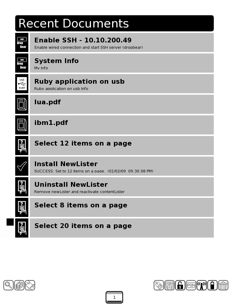

If you use the last command 'Reboot' of this tool from ContentLister, then catch you and your Iliad will be rebooting endlessly.
Why?
The answer is:
You last document/command opened is zz_reboot/run.sh, when the Iliad restarted and the newLister will try to open/run the last command zz_reboot/run.sh.
This script will reboot iliad again, so reboot endlessly. The only way to resolve this endless rebooting is to unplug your SD card.
If you installed the new ContentLister in Iliad internal memory and you do not install unbrickable tool, unfortunately used the reboot function in the newLister, then your iliad is dead.
Suggestion:
Please delete the REBOOT function from this tool.
Why?
The answer is:
Suggestion:
Is this for real? Can anybody confirm/refute this?
Why?
The answer is:
This looks the same as the problem ne14st mentioned...
I still do not understand: why would contenlister execute the last command? Mine doesn't?!?! Any what is happening?
I've put a warning in the first mail in this thread, and I'll update the menu soon.
henryhu: thanks!
Hans.
