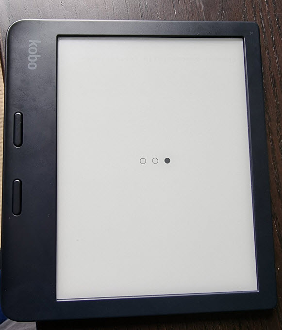

Hi All,
I have used instructions from NiLuJe to install Koreader (only, not Plato) onto my Kobo Libra 2 - using script file install.ps1 with OCP-KOReader-v2022.03.1.zip
All good, I can open pdf files and read. But everytime I exit Koreader (either using Exit or Reboot etc), it gets hang up in the middle with the dots and it does not allow me to even reboot using Power button! My current solution is to connect the device to my laptop and reboot while plugging in.
That means I can never read pdf as it will get frozen again if I try to exit from Koreader!
I even try to reset my device twice (2 times) and install Koreader with the above steps freshly - but still giving same issue!
Have any of you get this issue like mine? And is there any fix for that?
Thanks,

Do you have anything else custom installed on the device?
The libra 2 is known to suffer from fatal race conditions related to the EPDC and power delivery, so plugging it in is indeed one known solid workaround.
Since you appear to trip this with the boot spinner, you could also try swapping to the KFMon (on mobile, xrefs are painful, check it's docs) progress bar, but it might not change anything .

Early reports seem to hint at 4.32 having put a severe dent on the Libra 2 EPDC crazypants crashes, so you might want to try that once the dust has settled a little bit .

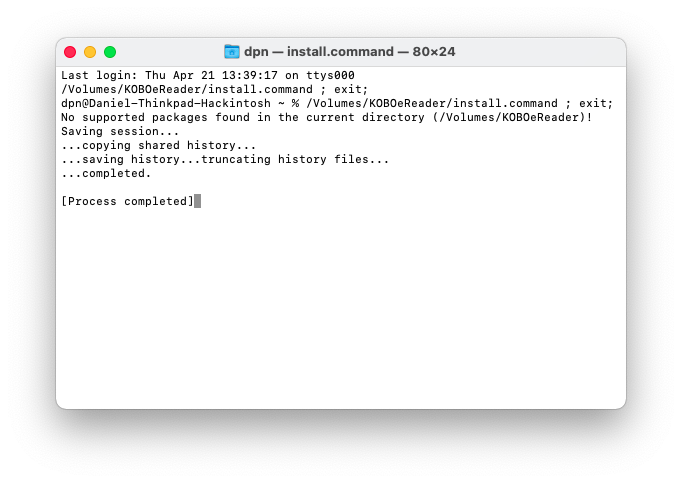

I can't install even I unzip or keep the zip file the root directory of Kobo.

@vinhphucng25: Do *NOT* run this from inside the Kobo's volume. It's mentioned explicitly in the docs. Unplug it until the last moment if that's the only way you can prevent yourself from manually dropping files in there .
