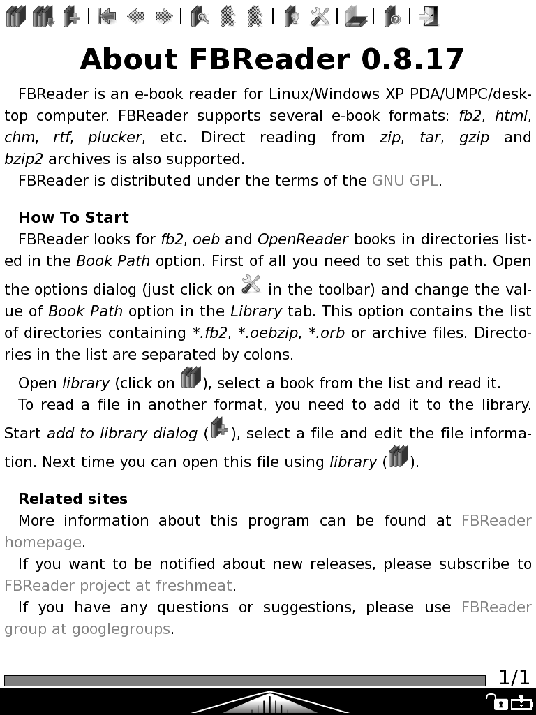

This is the first installer for FBReader running on the DR1000S.

To read a book, you'll have to add it to the library. You can do this by clicking the icon that looks like a book with a "+" sign.
You'll also need to close out of the program by clicking the exit button in the upper right. I plan to support the menu eventually, but I have to dig into that further.
To install: Unzip the file to the root of your SD card. For example, if your SD card shows up as the E:\ drive on your computer, you should have an E:\Programs folder after you unzip it.
After installing, you'll be able to select the FBReader icon from the Documents/Programs folder on your device.
You can toggle full screen mode with the select button (between up and down).

If you would like to open supported files directly from the Content Browser, see this thread.
The screenshots look very nice. Did you also port a screenshot program to the DR?
I made those running fbshot in the SDK, so they're not exactly "true" screenshots. Fbshot will run on the DR, but I have to set up a delay script.
