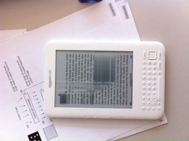

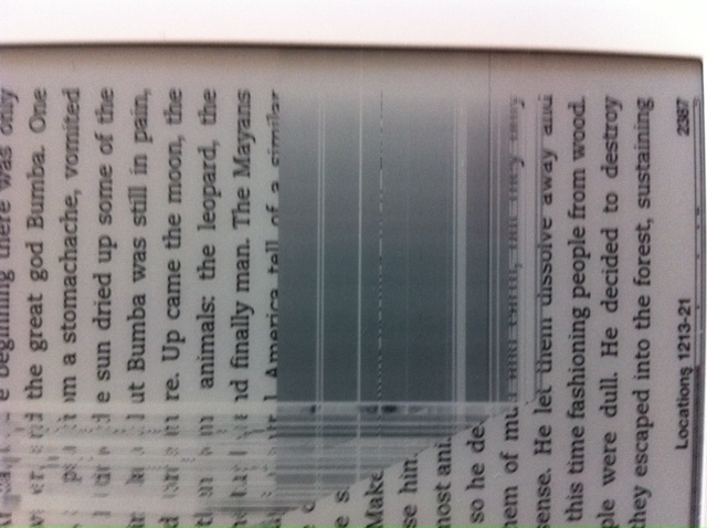

Hi there,
I left my kindle on my office desk in the unlighted amazon cover. This morning I tried to turn it on and now there are
strange stripes all over the screen that do not disappear even after doing a complete reboot. Pictures are attached.
Is the screen broken? The kindle was just sitting on my desk.
Thanks for your help,
Jens

Yes I'm afraid the screen unfortunately looks broken to me in which case there is nothing you can personally do I would suggest contacting Amazon about it.
Nothing fell on top of the Kindle did it?

Yes, I'm afraid that's a classic picture of a broken screen substrate. The crack in the substrate is the diagonal line towards the bottom of the picture. Unfortunately this is not covered by the warranty.

Odd that it got broken whilst in a case though. The eInk screen is generally broken because something pushed on the screen, something hit the screen or the entire device was twisted. The cleaners might have dropped it when moving stuff around on your desk to clean I guess?
eInk screens have a plastic top layer but there are very thin glass layers inside. This means you can end up cracking or damaging an internal layer but still have a completely intact top layer. The diagonal lines are usually an indication that the glass inside has cracked and where they join up is generally where the impact or pressure was.

I had a kindle 2 that showed similar symptoms. I did not recall dropping it or anything. I called CS, described what it looked like, having no idea what it was or whether it was covered by warranty Amazon replaced it and paid shipping both ways.
