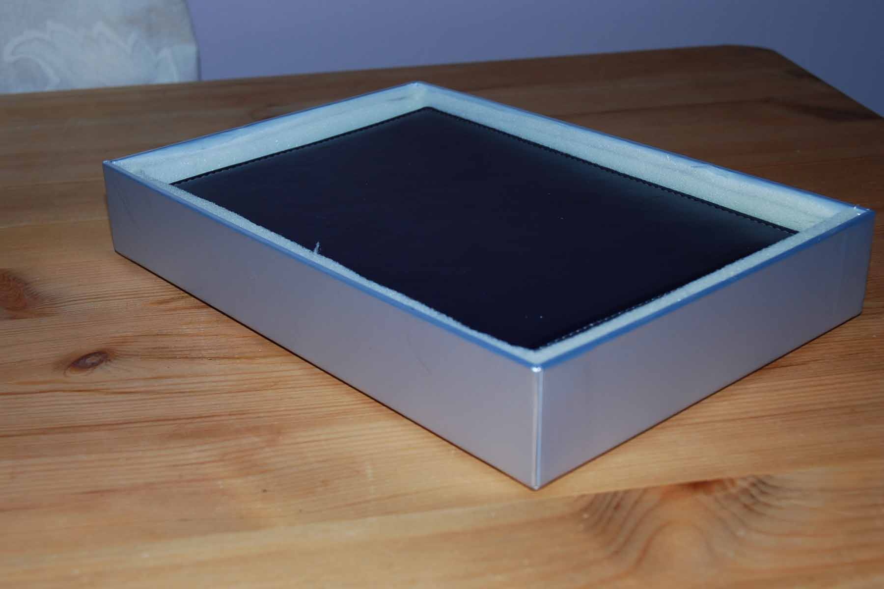

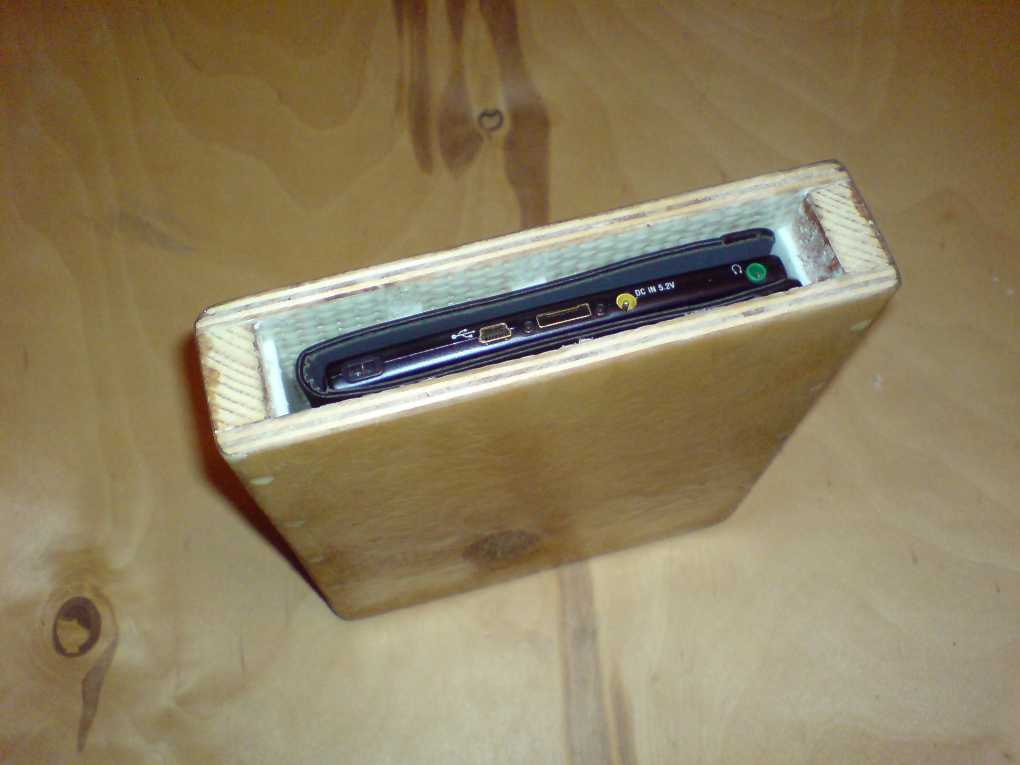

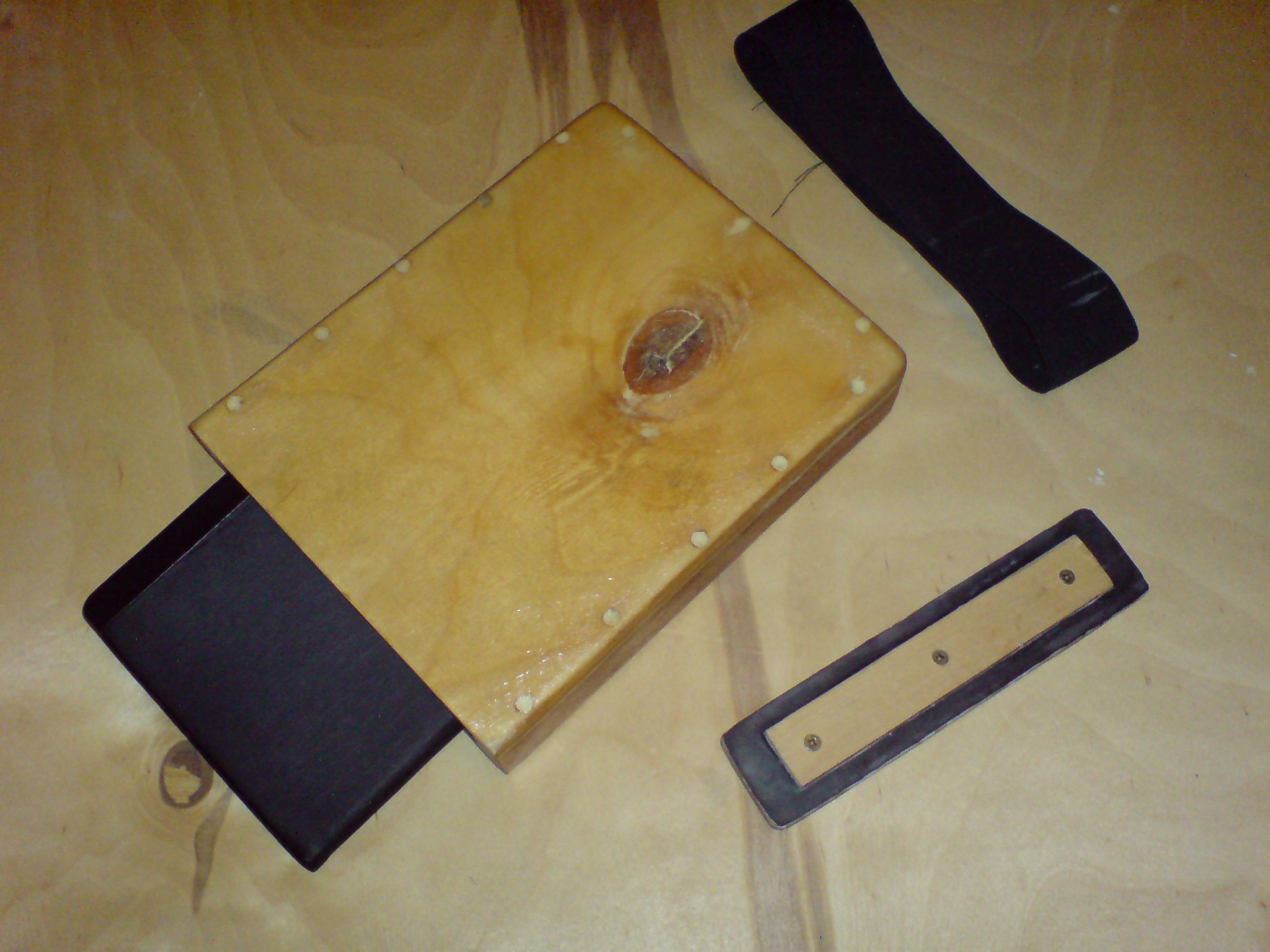

I have got two cases.
First one:
I measured my reader. Then I have cut two sheets of 5mm thick plywood.
I have laminated one side of plywood using thick glass fabric (500grams per square meter) using epoxy resin (I have had some resin with long past expiration date - this is why the lamination is not transparent).
Then I cut three sides from a piece of wood with 1cm x 3cm crossection and and glued and screwed them into the sides in such a way that the laminated layer is *inside*. Then I rounded the edges and laminated the outside of the case using finer glass fabric and epoxy.
Finally I have lined the inside of the case using remains self-adhesive strips of foam I have been using to insulate doorframe.
The construction is very quick, very ugly and very, *very* strong. The laminated layer inside gives the case very high rigidity. I think it can survive being run over by a car.
The second case:
I have been carrying a piece of cardboard cut exactly to the size of Reader in my bag from the moment I have arranged for my reader to be bought for me. I have been looking for a nice case (with that piece of cardboard in hand) everywhere I went. I tried numerous boxes, food containers, cases, suitcases, sets, toy containers ...
... finally I have found a perfect tin case. I have purchased a set of threading tools for $10 in a "super bargain" bin in a local Lidl supermarket. The threading tools are most probably worthless and will break during the first use. It does not matter. I was willing to pay that $10 (in my local currency) for the tin box alone.
I use the wooden box when I need extra protection for my reader.
The tin case is perfect for carrying my Reader in the notebook case together with a notebook on business trips.

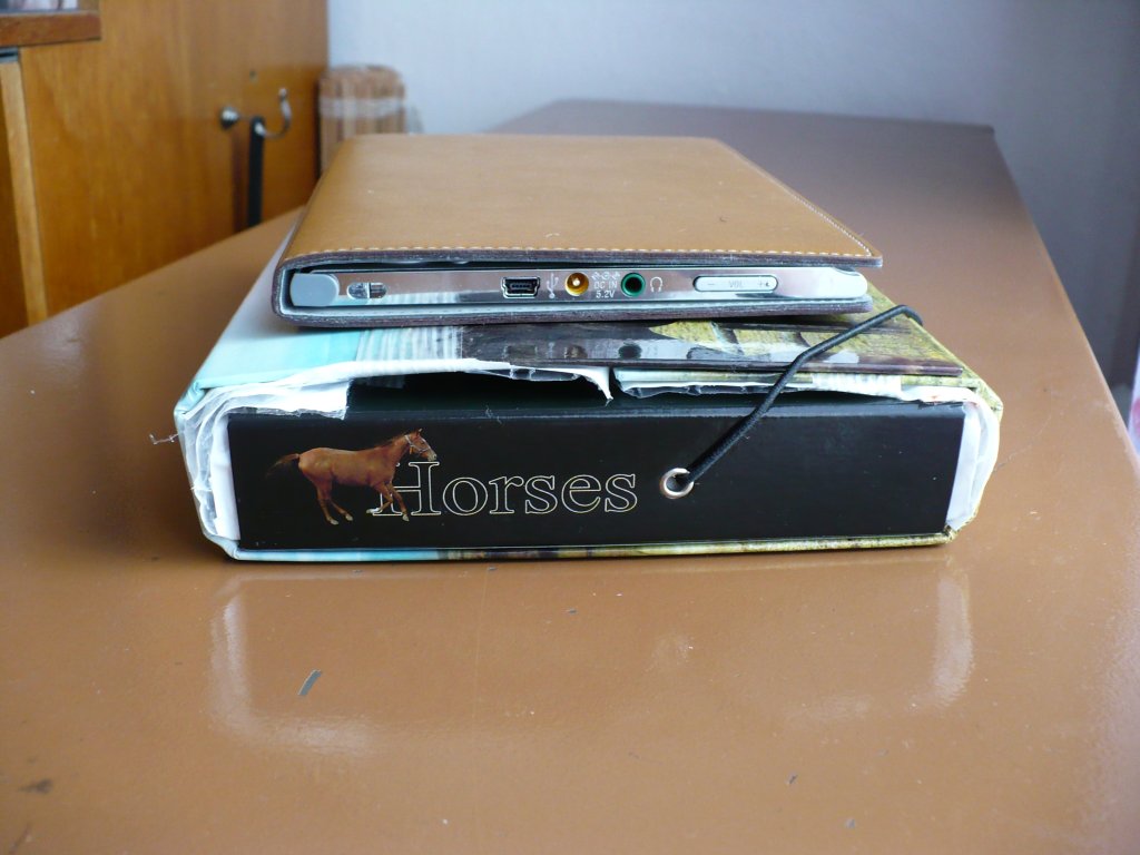

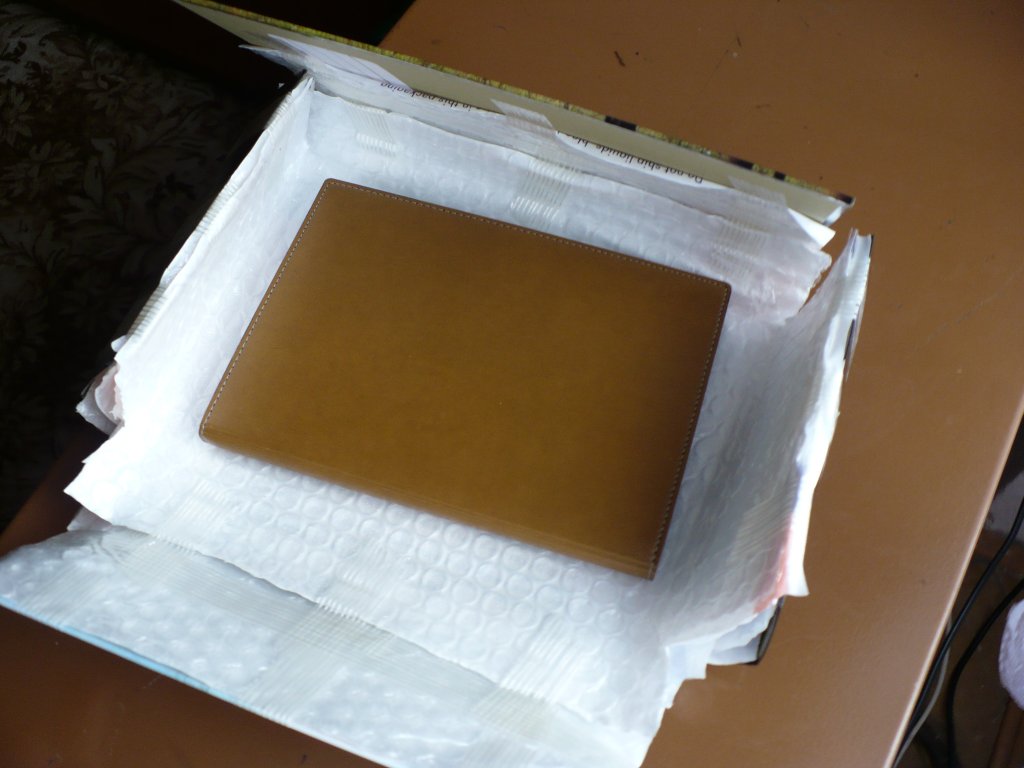

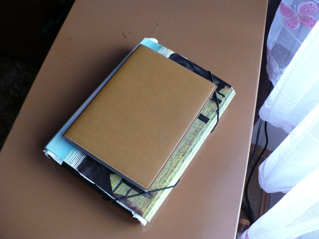

Here is my case. I havent found anything better in local stores yet so this is my $4 temporary solution for the reader protection (4 layers of bubble wrap and it fits perfectly).

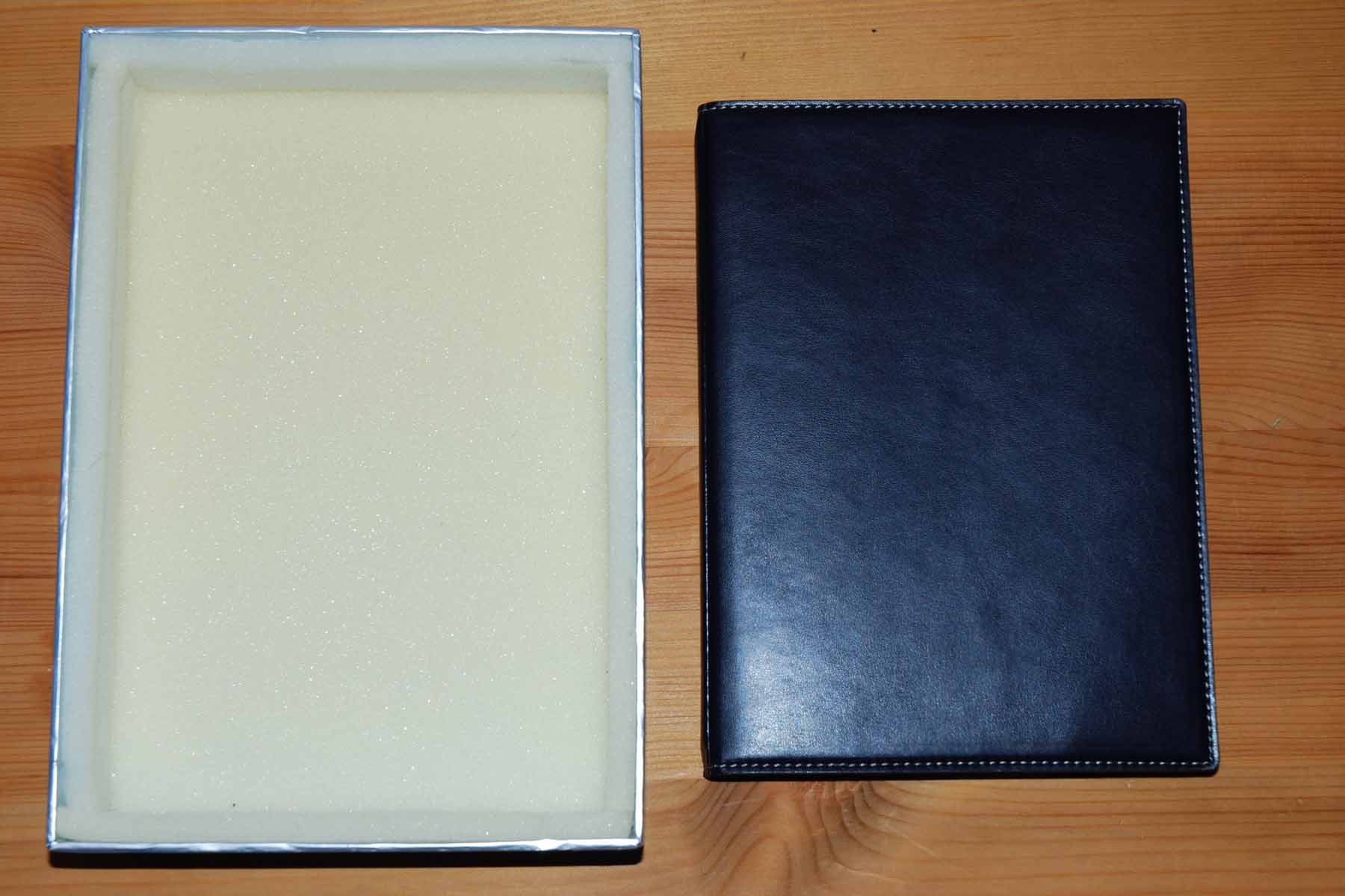

I made a case out of a good quality DVD gift box and I lined it with 5mm foam.
This gives a nice snug fitting, which keeps my reader safe.

Great tip!
It looks like I will have to visit several DVD/CD stores on my way from work tomorrow.

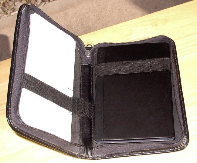

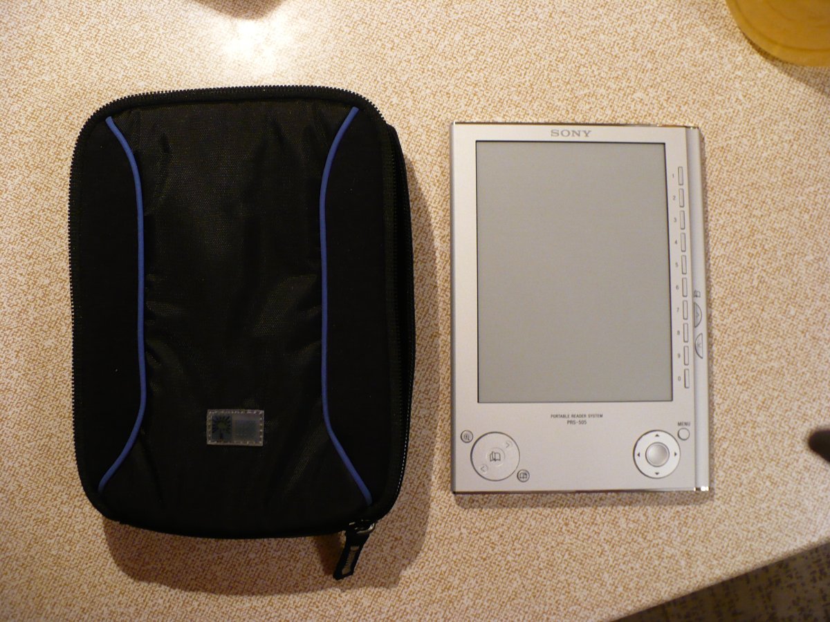

Finally I have managed to found something - case from CaseLogic (http://www.caselogic.com/mp3_travel_...?modelid=44255).
Well, it's not hard covered case but I have added extra layer from different hard case.

I saw this case at Walmarts and they all have fuzz and hairs all over them. They seem to attract dust/hairs like crazy, one reason I decided to find something else.
I've seem some harddrive cases but they are 4x6 in size, just a little too small.
