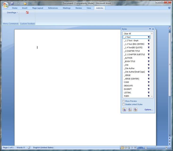

I'm completely lost. I got this new computer with Office 2007 installed. The interface is completely different. The only thing that is the same is that it was made by Microsoft. I got BookCreator.dot loaded. But were can I find all those nice buttons. I can find all the styles, I can find the macro's by opening the Macro menu, but it is a pita to use them this way. I must be overlooking something.
I know that some people are using BookCreator with Word 2007 so it must be possible. Can someone point me in the right direction?

No Book Creator macro's there. I switched off all security in the 'Trust Centre'. But when I go to the 'view' tab I can view macro's and run them. But I have no macro buttons anymore like in Word 2003. This way they are almost useless. I have to dig deep in the menu's to use them
The security must be okay because I see them, but the buttonbar is not created. Or it is hidden somewhere were I'm not looking

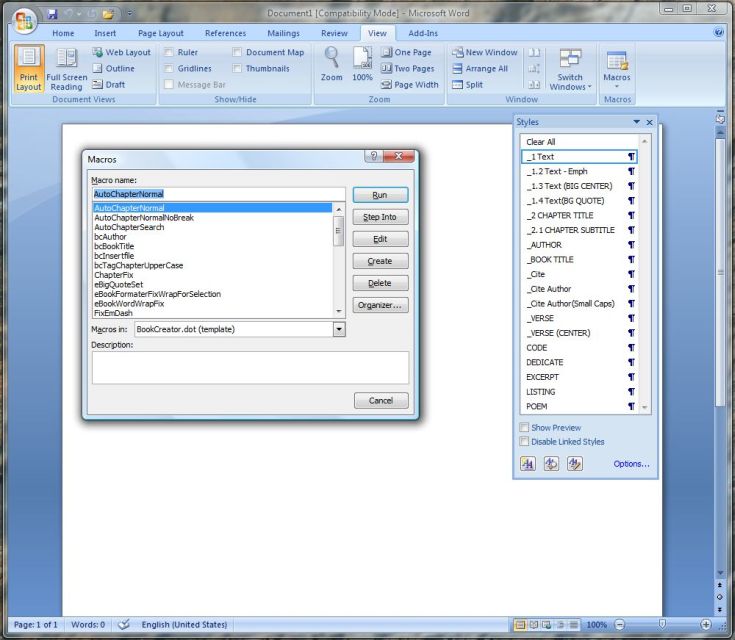

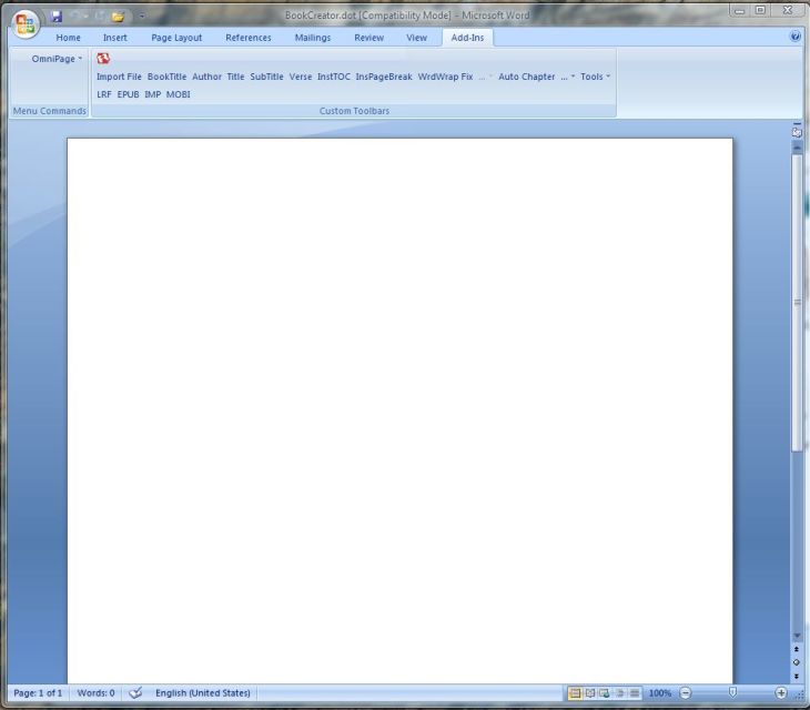

Hi, I did some testing.
It does not work when I double click the template. Word 2007 does open, the macro's are available but they don't show up on the toolbar. Screenshots are included here (Addin and ViewMacro)
It does work when I first start Word 2007 and open the template. That is screenshot 3 (Opentemp)

After a nice evening at the theater I got rid of the Omnipage software. I completely de-installed it. It didn't help.
I showed my problem to a guy in our firm who is giving the in company Office training and his answer was:
Well...Hmmm...euh...lets see...Yes...it is strange.
I will leave it this way. I can get it active by loading the template. It is not as convenient as double clicking, but it is a workable solution. And the macros of =X= are still as good as ever.
