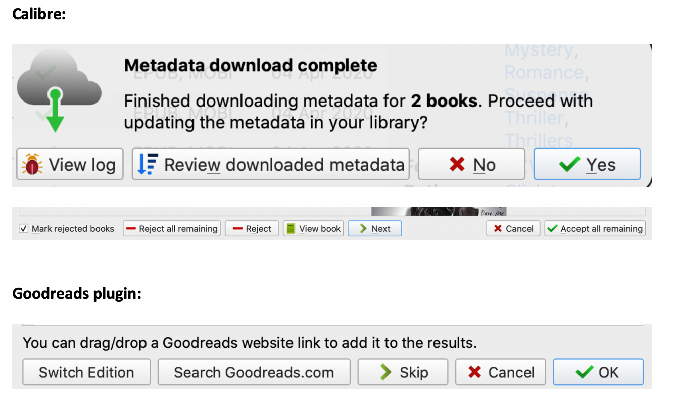

Sorry, what elements of the dialog is a different UI? Or, can you point to where in the calibre UI this dialog is inconsistent with?
And for the record, using "Approve" or "Reject" in this place would be wrong. As the dialog can show multiple matches, you are accepting or rejecting the match. You are deciding on one and then going to the next book. Or skipping the book because there isn't an appropriate match.
I made an example based on two books. See attached screenshot.
The first window could say -> Link to Goodreads complete
The UI logic is the same in Calibre if you download metadata. It could be more choices. In Calibre you see all choices immediately, so you do not need to switch - you can choose right there.
Sorry, but that isn't the same. Read my last paragraph above. That was typed thinking about that exact dialog. And it isn't even consistent with what you were suggesting. In this case "Next" means what you had as "Approve".
I am sorry, but it seems you have not checked my screenshot. From a logic point of view and UI calibre make it correct. Why do we need another bike if we have already one?
At the end of the day, it is just a suggestion that helps the user. If you think it is wrong or useless... let us focus only on fixing.
The problem is that I do not think that the methods used for downloading bulk metadata is suitable for use with linking the Goodreads book in this plugin. I do not think that doing an "accept all" is valid for this plugin. Based on my use, there are far to many cases were this would get the wrong book. And that includes when only one match is found.
For the individual book part, I do not think that the words used on the buttons are wrong. And I think that using the words that the bulk metadata download use would be wrong. The button "OK" is not perfect, but your suggestion of "Approve" is wrong. "Accept" might be correct, but, I don't really think it is much better than "OK". "Reject" is definitely wrong and I consider that "Skip" is a better description of the action.
I see your point. However, if we speak about "Reject" we mean "I do not agree with the choice". "Skip" logic means "I do not want to talk about it now". Regarding "OK" and "Approve", it is up to you...have you seen "OK" stamp in some state departments?
Please understand me correctly; I do not want to teach you logic etc. (my specialization...PhD). I just wanted to help a bit. In the end, human adapts to almost everything.
