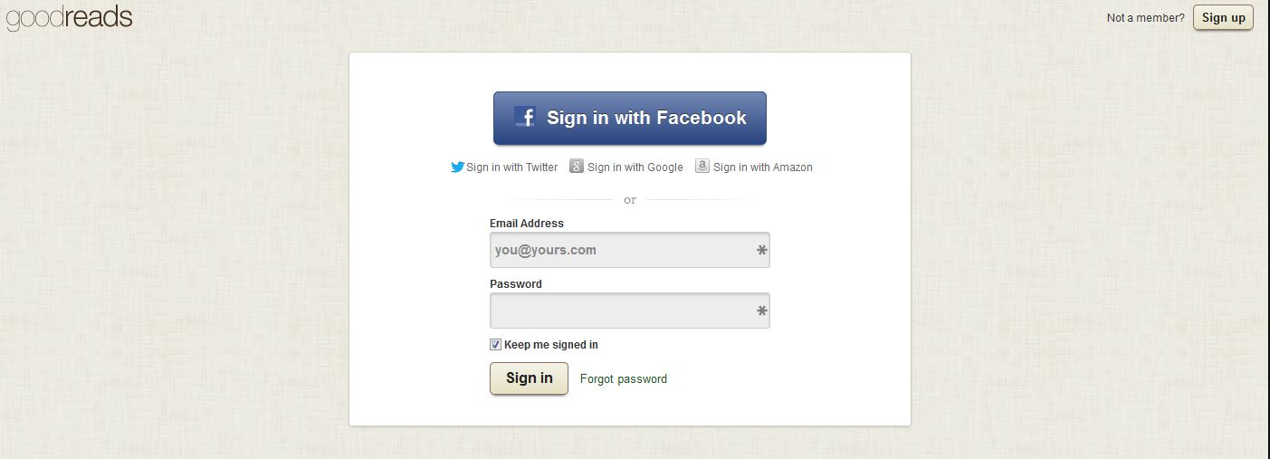

@neonatus - following on from kiwidudes post I installed this PI into a fresh Portable install - I then Authorised it using a moribund FB account, seems to be installed and working OK - see attachment for what I got when I did the authorise - BTW the url for that page was
https://www.goodreads.com/user/sign_in?mobile=false&remember=true
Suggest you try again, and if no luck then do as kiwidude suggests, contact Goodreads support - maybe your IP is blocked from this service for some reason.

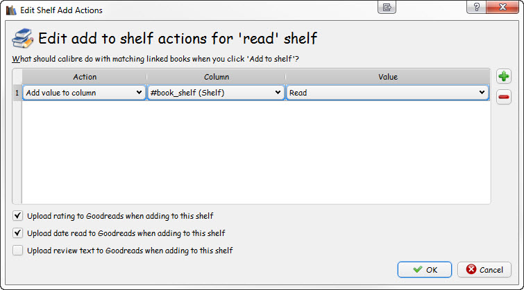

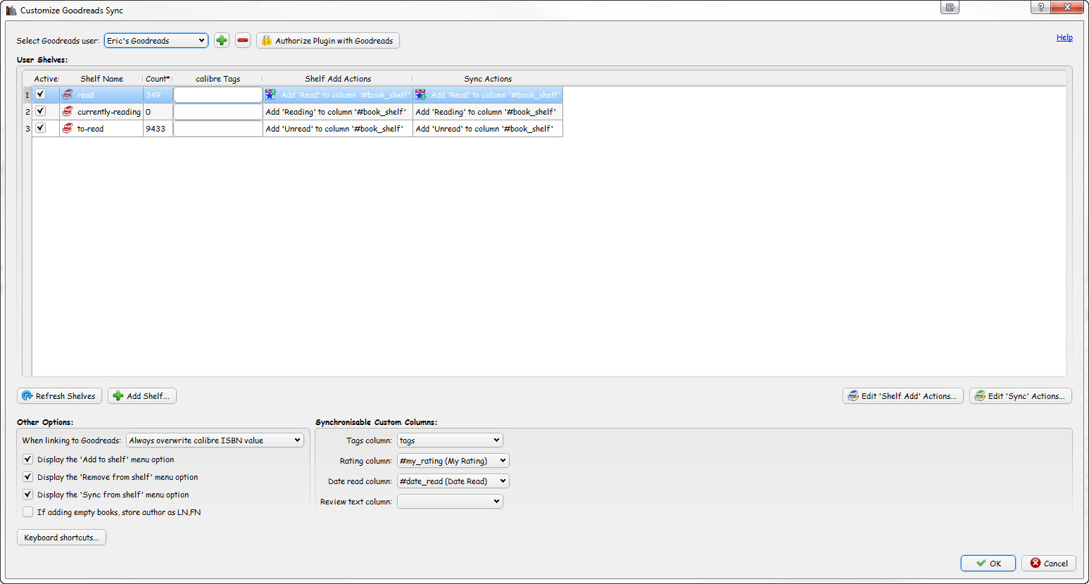

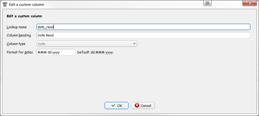

I have done this in my calibre/Goodreads Sync set-up and it works fine. I have included screens shots of how I set-up my custom field and how I configured Goodreads Sync.
You should verify the following:
1) Your read date column must be defined as Date. The Date Read column selection will only pick up fields defined as Date, and I believe only custom fields.
2) Under Shelf Add Actions and Sync Actions, you need to indicated whether the read date should be uploaded/synced for a shelf. When these are set for the shelf, it will include the Date Read as a column during any syncing action to that shelf (Date Read value will default to current date but you can edit it before Syncing). It is done at the shelf level so you can set Date Read when syncing to your Read shelf, but not when syncing to your to-read, and/or other, shelves.
I hope this helps.

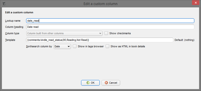

Thanks edwdecarlo, that works but only if the field has a column type set to Date. I created a new custom field to test it.
I import the date read directly from my Kindle and use a custom field set up like the attached. Unfortunately this doesn't get picked up

Ahh, now I see the issue. The way you created your date_read column it is not an actual storage space, it is a calculated field, which only displays existing data in a different way. Think of it as a virtual column, or Display Only.
To interact with Goodreads Sync, the Column Type must be Date.
