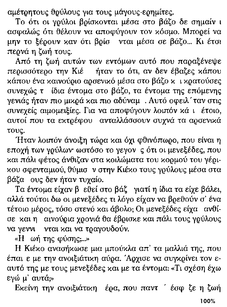

Hello Willus,
I am facing a problem which has nothing to do with your excellent software, but with your knowledge on pdf files, you may be able to give some advice.
I have a kindle paper-white (2nd generation) for reading my books. I mainly read Greek literature (since I am Greek) which I find in pdf format.
The problem is that most of those pdf files are not properly displayed on kindle; some characters are just not shown. Those are Greek characters (for example Greek “e-epsilon” ,“k-kapa” or “s-sigma” or vowels with accentuation).
I managed to partially overcome this problem by saving the file using “Adobe Acrobat Pro X” software as optimized pdf with specific settings. Then everything is displayed properly on kindle but the file is 5 to 10 times larger than original and less clear.
The funny thing is that on kindle keyboard everything is perfect. I talk to Amazon customer service but they could not find a solution. Their last word was that after all pdf reader is an experimental one.
I am thinking that there may be an other way/software to use for making those “missing” characters display on kindle, without side-effects...
I am attaching for you, a test page on pdf file, a screenshot of how it is displayed on kindle, and the settings I use to optimize the file.
Any advice would be appreciated.
Thank you for your time.
Angelos

Originally Posted by willus View Post
Angelos--the file you attached (test1.pdf) is still just a bitmapped PDF. Are you sure it does not display correctly on your Paperwhite? Can you please attach (1) a screen shot of a PDF not being displayed correctly on your paperwhite, and (2) the source PDF file which does not display correctly?
Willus,
I have attached a screenshot from kindle in my first post.
For your convenience I re-attache it again.
Check for example line #4, word #6:
The word "βρίσκονται" is displayed as "βρίσ νται".
This happens on every other line; you may not easily spot the differences because you don't read Greek.
Regards,

Originally Posted by agelos100 View Post
...Check for example line #4, word #6:
Angelos--Thank you for your patience. I see the issue now. You are exactly right--I don't read Greek so it was not obvious to me. Since your PDF is simply storing JBIG images, I'm thinking the paperwhite PDF reader must have a bug in the JBIG decoder. Hopefully Amazon will fix it in a firmware rev. By "optimizing" you are changing the bitmap encoding and that's fixing your problem. I'll see if I can recommend any better settings.
The word "βρίσκονται" is displayed as "βρίσ νται"...
Below is the output from "pdfinfo" on your PDF file (pdfinfo is in the MuPDF distro). You can see it has a JBIG2 bitmap that is 1 bit-per-pixel in depth (black and white). The compression to get that bitmap down to 22 kB is impressive--30 to 1. Even a 1-bit-depth PNG file compresses to only 96 kB--4 x larger. Clearly JBIG2 compression format for this bitmap is done very well--I'm wondering if it doesn't somehow compress the bitmap for each letter (or common combination of letters) internally and then overlay them? I don't know enough about JBIG2 compression capabilities, but it may well be because the JBIG2 compression used in test1.pdf is doing some "special" tricks that the bug in your paperwhite's firmware has been exposed. I'm guessing there must be other software packages out there that will re-compress images inside a PDF, but I don't know of any that will be able to get to this kind of compression level/quality. Maybe some other folks can chime in? (Or you could start a new thread with the specific question about re-compressing and/or changing decoding of images in a PDF file.)
PDF-1.6
Info object (21 0 R):
<</CreationDate(D:20131209141435+02'00')/Creator(abs)/ModDate(D:20150410155724+03'00')/Producer(K2pdfopt v2.12)/Title<>>>
Pages: 1
Retrieving info from pages 1-1...
Mediaboxes (1):
1 (1 0 R): [ 0 0 223.4717 301.92452 ]
Images (1):
1 (1 0 R): [ JBIG2 ] 1861x2842 1bpc ImageMask (15 0 R)
Form xobjects (1):
1 (1 0 R): Form (13 0 R)
