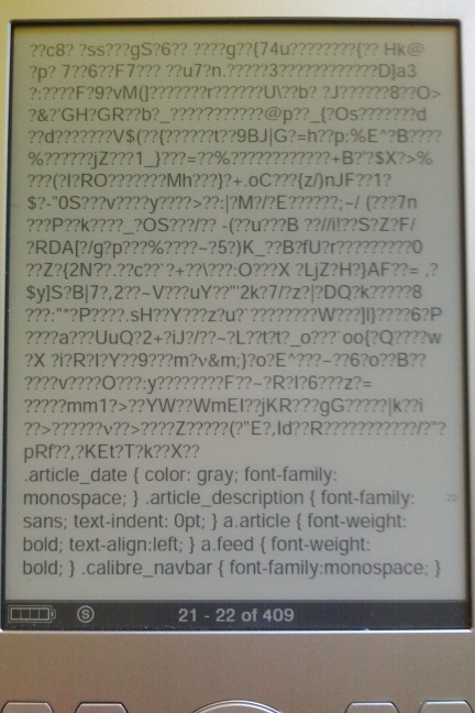

I am afraid I found some more problems. I don't really mind issues 2-4, but would like to solve them if it's easy. Issue 1, however, is more of a critical error.
Issue 1: Some articles show up with completely garbled text (see "gardbledText.jpg"), both in Calibre and in my PRS-300. Every time I download the news, the articles that show up corrupt are different ones, so it's not an issue with a specific article. Problem with the server?

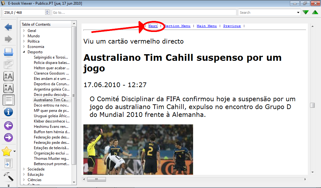

Issue 4: Some articles have the "Next" link disabled. Under PRS-300, I cannot navigate to them. Under Calibre, clicking on them makes no difference. This happens with the "Australiano Tim Cahill suspenso por um jogo" (9th) article from the "Desporto" section, for instance. Any EASY way to solve this?
I've never seen this behavior before. I'd need to reproduce it and run tests. Typically, I use pre and postprocess_html then print the Soup. That lets me look at the raw html at different stages. I can't do it now.
I'd need to look at the link and the recipe. If there is a link on your source page, AFAIK, it won't follow unless the recursion is turned on. Even then, you may want to control following with match or filter_regexps. For a "Next"
link, are you following to the next page or the next article. If the former, I'd be looking at multipage code. If the latter, I'd hope the article was already in the feed.

As always, thanks a lot for your help, Starson17.
Pre and post stuff is in the ZIP attachment from my previous post. Is that what you mean?

For a "Next" link, are you following to the next page or the next article. If the former, I'd be looking at multipage code. If the latter, I'd hope the article was already in the feed.
It's just going to the next article, there's no multipage used in these feeds. Yes, the article is already in the feed, as I can get there one pageturn at a time.
So if it's just going to the next article, why not strip that "Next" element and not worry about whether it links or not?
Then I do it with postprocess_html. This lets me see the html sorted by BeautifulSoup at different stages. Your garbled text is presumably not garbled on the source page, so it's getting garbled during processing. This would help track down where it's happening.
I've checked the folders created by the debugging mode and it seems that the articles are corrupted on download. That's weird, because it's always different articles every time.
I tried limiting simultaneous_downloads to 1, but that didn't solve the issue.
I think we are misunderstanding each other. Please check the attached image. The "Next" link I mean is the one at the top, on the navigation menu.
I downloaded the news to LRF instead and noticed that the "Next" text did not even had link formatting in Calibre, while it did have link formatting in ePUB, but didn't work. It's like there is no link at all, rather than a non-active link.
That is odd. I've never seen it before.
Yes, I misunderstood. I thought you were referring to links on the page, not navigation bar links. The navbar links are created as the html is constructed. Typically, the Next link on feed_0/article_0 is to feed_0/article_1/index.html, which has a Next link to feed_0/article_2/index.html, etc. until the last article in feed_0, where the Next link points to feed_1/index.html.
The last "Next" link is invalid if there is no next feed. I suppose it's a bug, but not one I notice, as I don't use the navbar. If your next article's index.html isn't built, that would make an invalid Next link.
