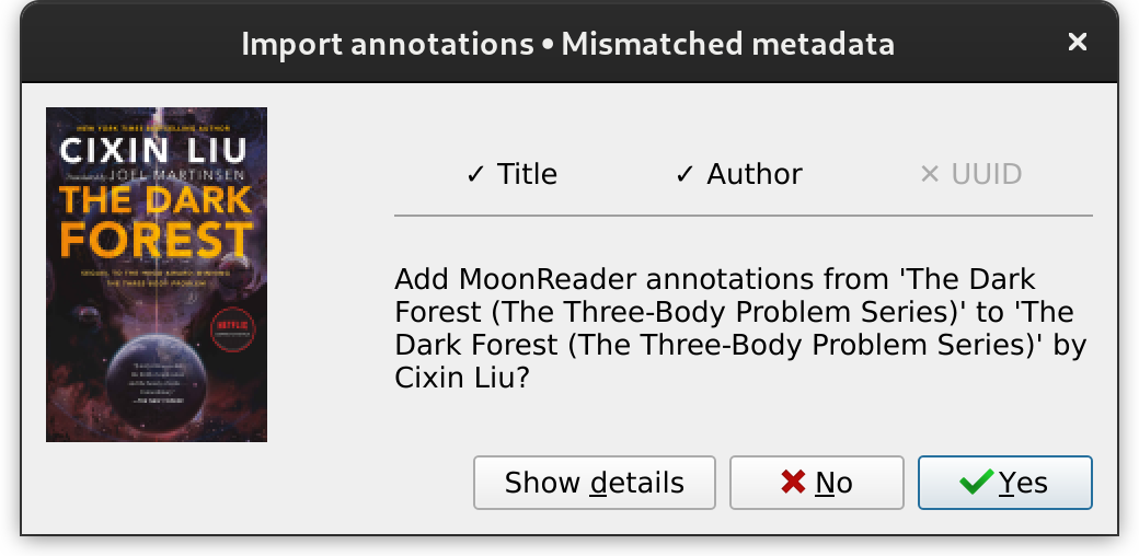

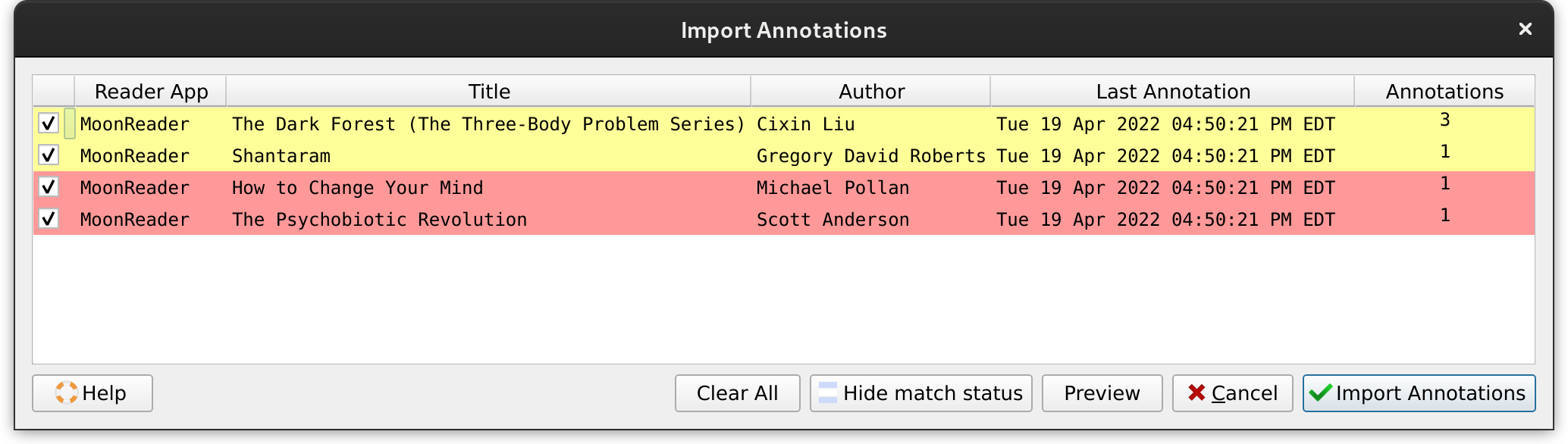

I also have some questions about the behavior of matching in the plugin.
- If there is no match, the plugin's behavior adds the annotations *by default* to whatever the selected book in the library is. I can get on board with that happening if the user asks, but could this be changed so the red entries (no confidence) aren't checked by default?

- If there is a match, but not on UUID, the plugin prompts for each book to confirm the match. For Moon+, I obviously don't have the Calibre UUID's. Could I maybe change the behavior to add filename into the mix? I do have that, and I think if title + author + filename match, confidence of "3" should be OK and the annotations automatically imported. WDYT?
