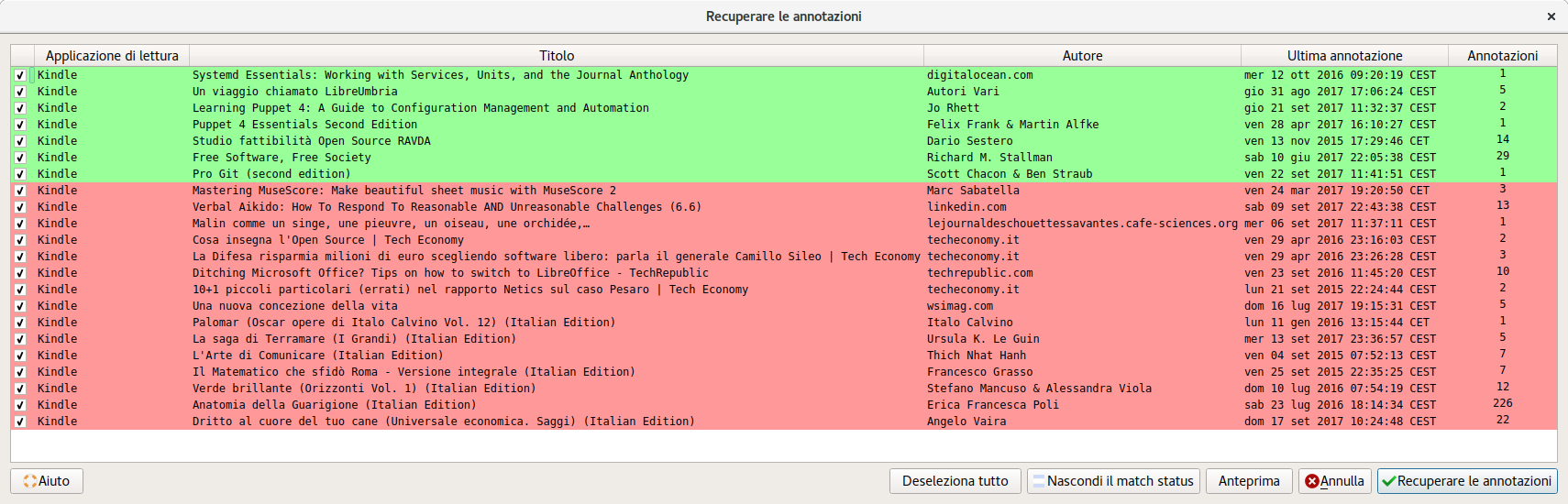

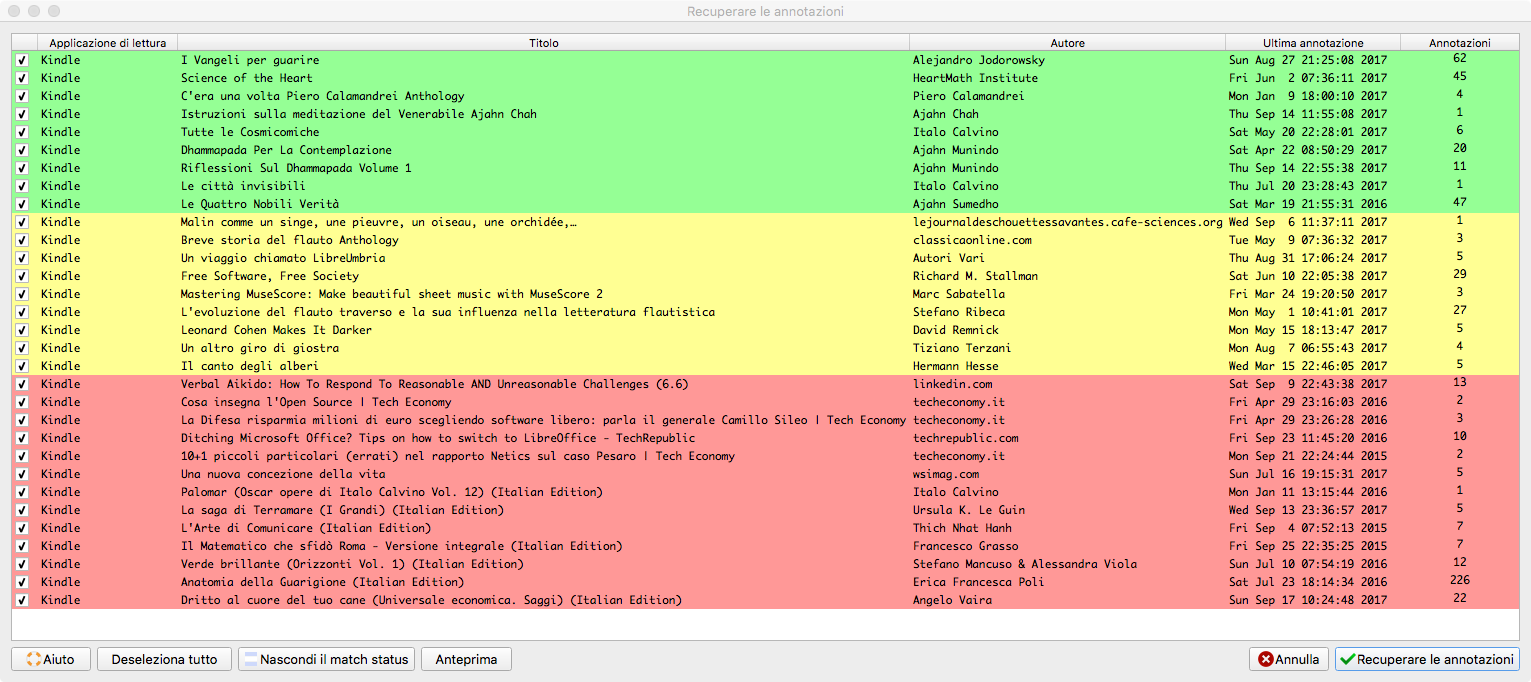

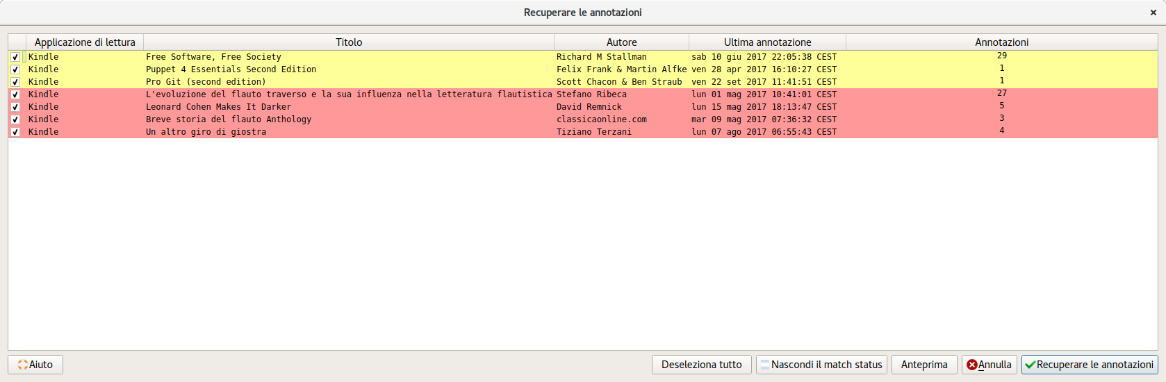

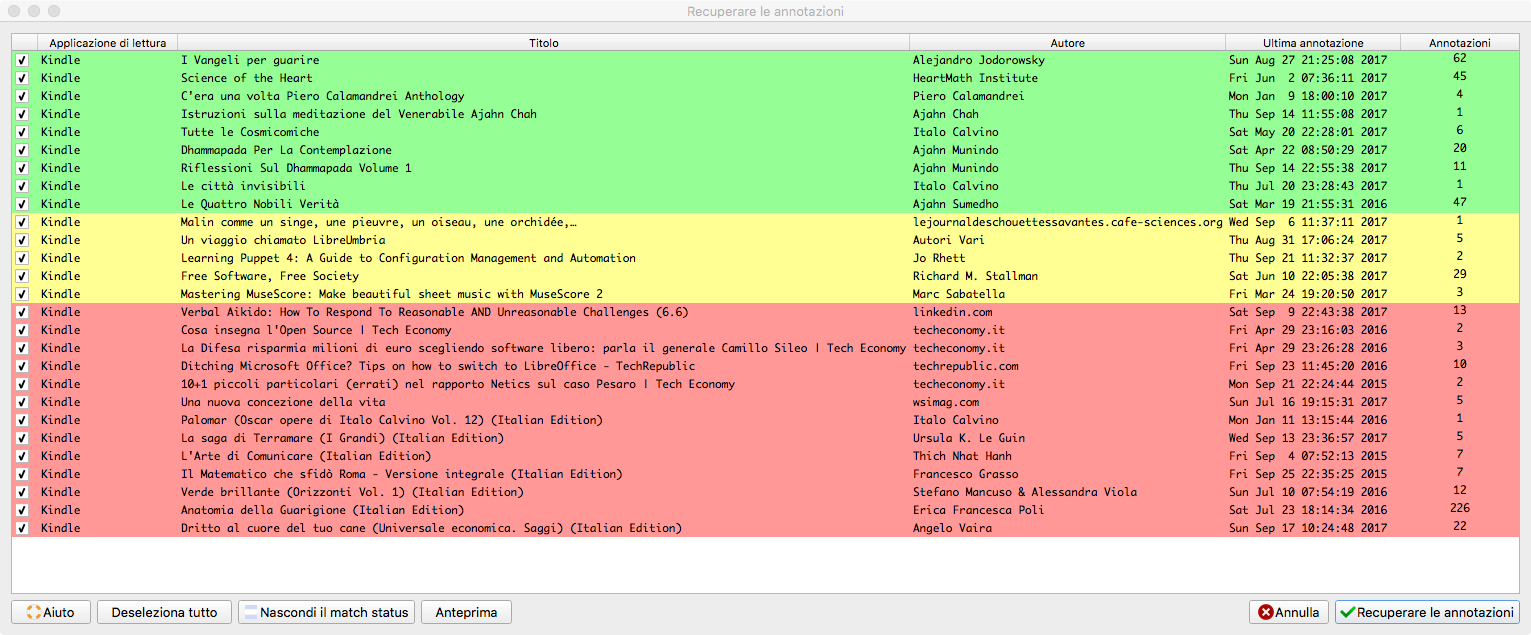

OK David. I have my ebooks subdivided in different libraries and I work with both a GNU/Linux workstation and a Mac.
Attached you find two images from my Linux workstation showing fetched books with the previous 1.4.6 beta and the last 1.4.8 one when the library 'Informatica' is selected as current Calibre library. As a side note, I would like to mention that this window now is correctly resizable on Linux too, while previously on Linux appeared blocked with a size bigger than the screen estate.
Attached you find also the Calibre log obtained enabling the plugin debug log and restarting Calibre in debug mode with the kindle connected.
Furthermore, you find other two images from my Mac showing fetched books with the previous 1.4.6 beta and the last 1.4.8 one when the library ‘Calibre Library Dario’ (my main library) is selected as current Calibre library.
Finally, the full MyClippings.txt is also attached.
Hope you have enough information for debug :-)

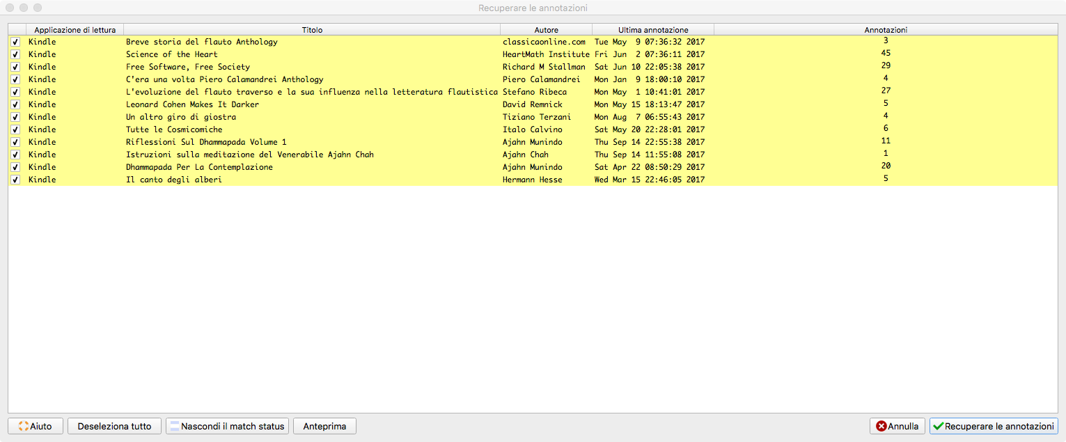

are there any patterns you can see? Format is the obvious one. And source - sideloaded, emailed to Kindle or bought and downloaded - could also be involved. Are the books shown as on the device in calibre?
Hi, just to summarize my findings until now:
email to kindle: ok
sideloading mobi, azw3: ok
downloading mobi, azw3: I need to investigate
downloaded kfx (the format that nowadays Amazon use for most books): no
Attached you find the image of the fetched books from the latest beta: like schnesim I got more annotated books fetched than with 1.4.8.
Ciao,
