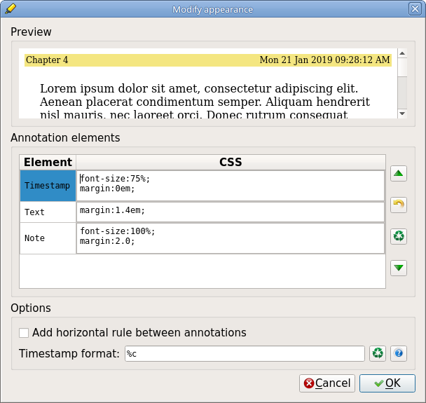

The sample CSS view for the editing of Annotations appearance shows:
Location heading/Chapter + date-time
Highlight.
Note.
That is indeed what I get if I use this plugin with the Kobo. Though I find the Kobo Utilities is better.
What I was getting with the PW3 is
Location number only + date-time
Highlight with following Blankline (can't be moved)
Note.
I'm now getting the blank line at the correct place!

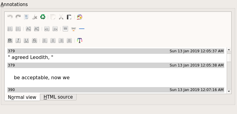

378	Sun 13 Jan 2019 12:04:32 AM
silent for a while. “That would be acceptable, now we
379	Sun 13 Jan 2019 12:05:37 AM
" agreed Leodith, "
379	Sun 13 Jan 2019 12:05:38 AM
390	Sun 13 Jan 2019 12:07:16 AM
a
390	Sun 13 Jan 2019 12:07:17 AM
have tape somewhere
406	Sun 13 Jan 2019 12:08:57 AM
aall
406	Sun 13 Jan 2019 12:08:58 AM
Anything at personal from
Having location numbers are useless on their own. I need chapter names.
Essentially the Location number only + date-time is the same for pairs of Highlight + note. You can have a highlight with no note.
I can't see why the Annotation plugin has LESS info than my clippings and repeats the heading as in My Clippings.

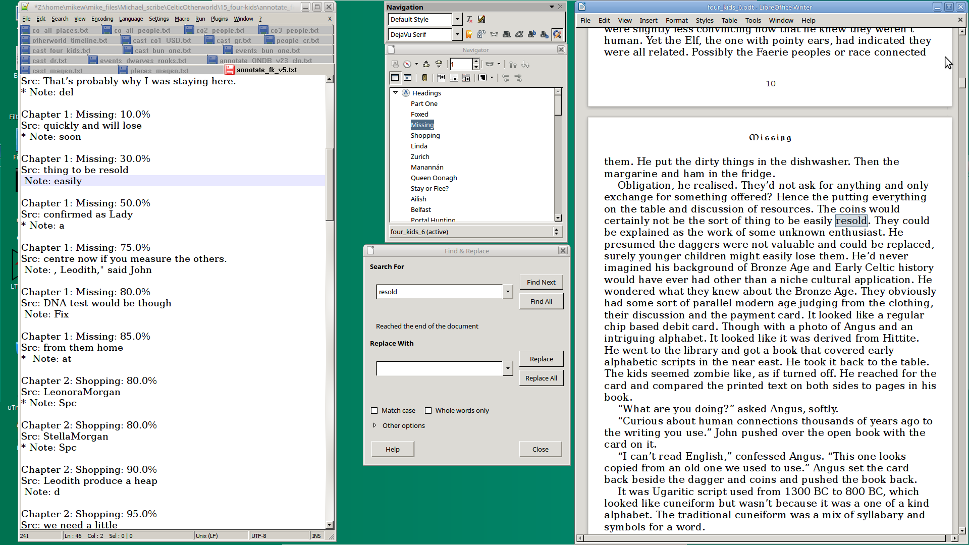

Note, I'm not interested in storing the annotations in Calibre, I have Notepad++ or SublimeText on left side of screen and Libre Office Writer on the right.
I mark off in the text file what I've done, in front of the note * = source edited, X = note discarded. Or some other comment.
For the import to Calibre or upload to Web, the header and footer removed, body is fully justified, TOC has page numbers removed etc.

HTML source from Calibre Metadata
Text from Metadata
2957	Tue 15 Jan 2019 02:49:44 AM
Beth and her husband Niall. Anrhi
2958	Tue 15 Jan 2019 02:50:24 AM
Niall or Brian?
2960	Tue 15 Jan 2019 02:51:02 AM
Órlaith’s parents, Danny and Laragh. The two older
2960	Tue 15 Jan 2019 02:51:51 AM
The two older
2961	Tue 15 Jan 2019 02:51:50 AM
De two older
Thanks for the HTML as that allows me to see what the plugin produces. But, going through the sample from the My Clippings.txt, it isn't completely obvious which highlight and notes are connected. I would assume the ones with the same timestamp and location. But, that doesn't appear to be it. Most of the notes have a later timestamp than the highlight. It is only a few seconds, and probably represents how long it took to tap in the note. But that makes it harder to be sure the note and highlight are associated. And in the Kobo, I can make a highlight or bookmark and add a note to it later. Is this possible with the Kindle? If so, it makes it much harder to be sure of the association between the two.

but certainly it's needlessly repeating identical time stamps for note and source highlight,
Where is it repeating identical time stamps? There is one repeated timestamp in your My Clippings.txt sample ("15 January 2019 02:51:50"). There are none in either the HTML or the text version.
contrary to CSS preview and only putting location, not location range or page, at least I think so.

I thought of writing a program to process "my clippings.txt"
Be my guest.
Edit:
The "my clippings.txt" clip is newer than the Calibre import as it ends that book with
