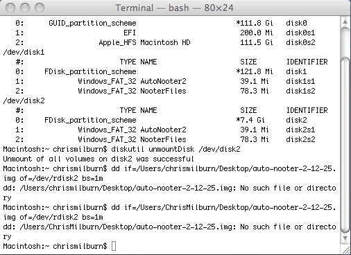

Here's where I stand for now. Am I missing something?

Why do you have /dev/rdisk2, shouldn't it be /dev/disk2?

Ok, fixed that, but still nothing...

What is your present working directory (pwd)?
I worked out of the same directory as where the image was downloaded to.
All I had to type was:
dd if=nooter_sdcard_40mb.img of=/dev/disk2
My image is different from what you're using, so disregard that.
Try taking the image off the desktop and place it somewhere else.
